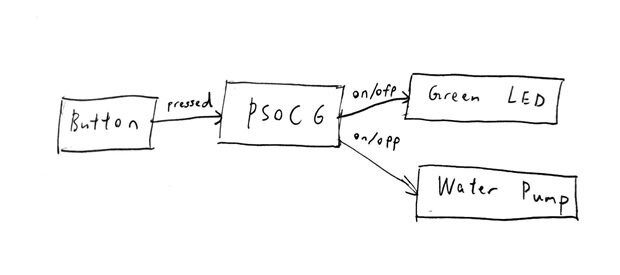

Block diagram:

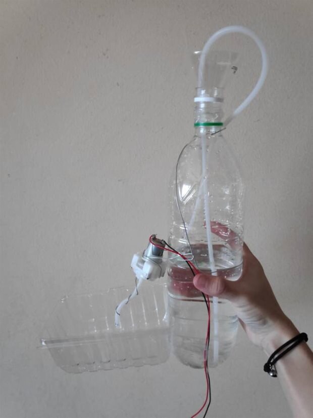

Physical structure of water dispenser:

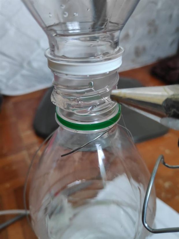

cut the top part of the 500ml water bottle and glue it on the top 1.5L water bottle to form a funnel shape for easier water input.
by using steel wire and hot glue gun, attach the water pump and hose, plastic tray, and water bottle as it shown in the picture above.

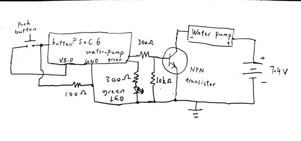

Schematic of water dispenser:

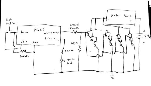

Initially, I have planned to connect the PSoC6, green LED, and water pump according to the schematic above. However, I have noticed that the current flowing through the water pump is too small to actually turn it on.
After checking the datasheet of my NPN transistor, I notice that the maximum rated current for the transistor is just 150mA and it is obviously not enough for the high current required to start the water pump.
The best solution would be just replace the NPN transistor with a NMOS transistor. However, due to the Covid-19, the NMOS transistor that I have purchased online is taking a longer time than usual to be delivered to me. As an alternative, I have decided to connect the NPN transistor parallelly to provide a higher current to pass through it. I have also cascaded the NPN transistors and to provide a greater amplification since the current supply from the PSoC6 is not sufficient to activate the water pump using only one stage on transistor.
After some trail and error, the picture below is my final version of my water dispenser schematic:

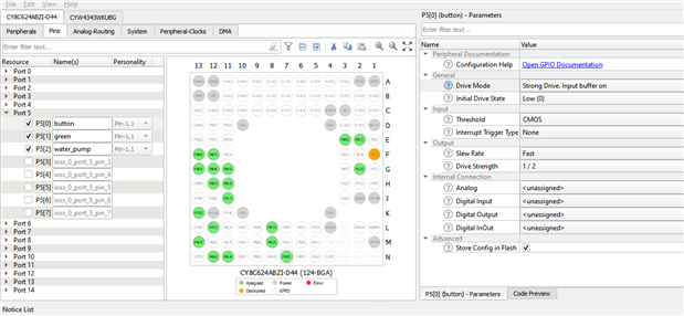

As always, I create a new Empty_PSoC6_Apps in ModusToolbox.
Using the basic interaction with ModusToolbox and Device Configurator that I have explained in my past blog post:
Configure pin for button, green LED and water pump.
I have selected Strong Drive. Input buffer on as the Drive Mode and Low(0) Initial Drive Stare for all of the pin. I will implement the pull-down resistor for the button pin at the hardware level in this case.
