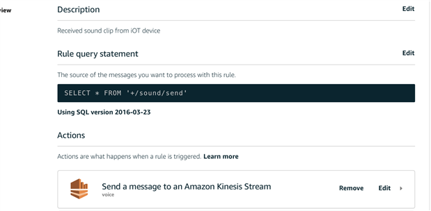

In order re-route received data to AWS Storage (or other application), we added a "Rules"
Rules
Under Act > Rules, Click Create
Rule query is:
SELECT * FROM '+/sound/send
which the rules received topic [anyname]/sound/send, as we designed use topic "ThingsName"/sound/send to received the data.

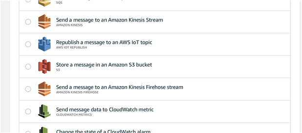

Select "Add action", select "Send a message to an Amazon Kinesis Stream"
(not Kinesis Firehose, we first choose Kinesis Firehose stream which is much easy for storage but not good, we will mention later.  )
Stream Name: voice
Partition key: ${Topic()}

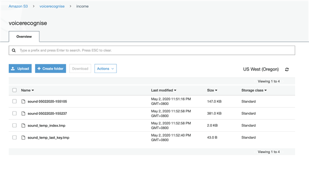

S3

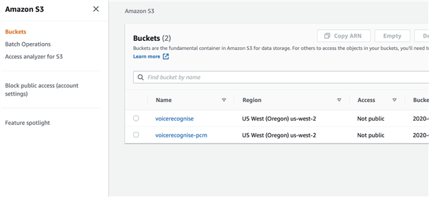

Other platform may more efficiency,  however, for simplify, we choose S3 instead of other advanced database or storage platform.
Open Amazon S3, Simple Added a new Buckets "voicecognise"
Not public is fine, we save/retrieve though private channel.

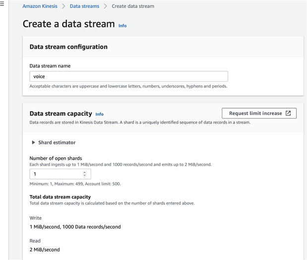

So we use the Kinesis Data Streams instead of Data Firehose as main reason it have faster response so our Lamba function to process the incoming data within seconds after received.
Data stream name: voice
Number of open shards: 1

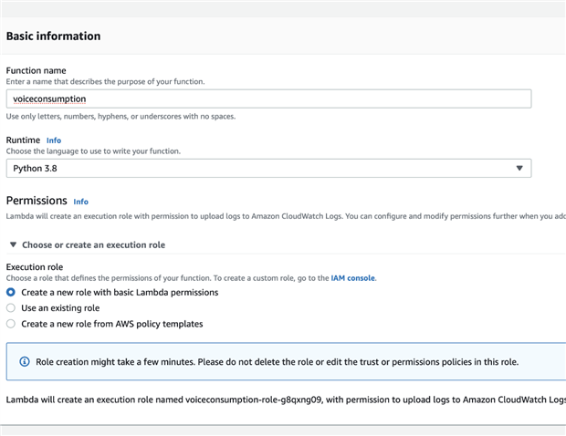

Under AWS Lambda, Create new Functions, name voice_consumption

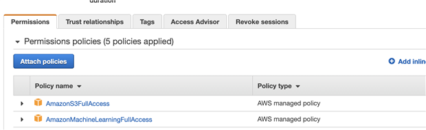

Select Python 3.8  and Create a new role with basic Lamba permissions
Open the created functio, select Permissions > Execution role, click the Role name and open IAM
Attach policies AmazonS3FullAccess

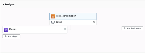

Under Lambda, Configuration, Open Designer
Click     + Add trigger
Select "Kinesis"
Kinesis stream > voice
Other leave default.

The Kinesis Stream will trigger this function after stream arrived
The brief of the function is:
1. A temp list storage sound clip timestamp
2. A temp string storage writing file
3  Decord the data from BASE64 to raw (working for twice because AWS kinesis will also encode another BASE64)
4. Retrive the timestamp from last 8 bytes payload.
5. seek the position and insert the sound data to correct sequence
6. Create another file if no sound data more that 2.5 second
7. Save data to S3 Storage
