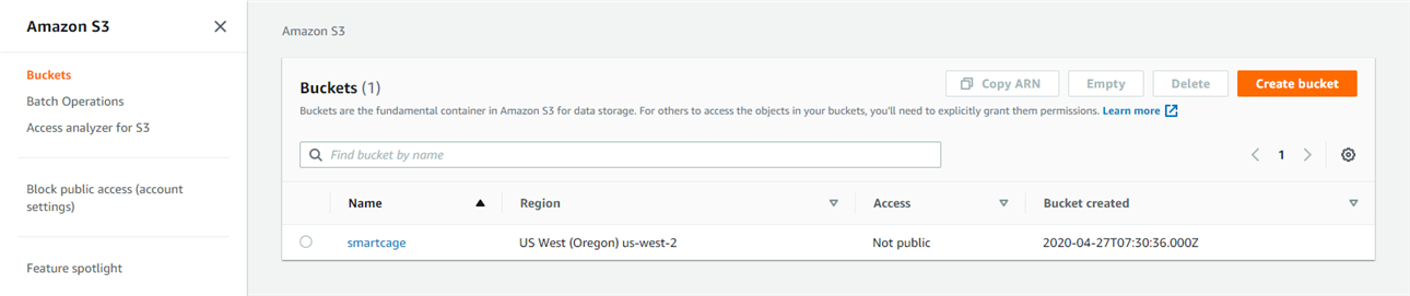

To check available Buckets, I selected the S3 service, and a list showed up:

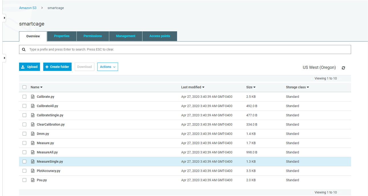

To check the "smartcage" Bucket, I clicked it and got its content:
