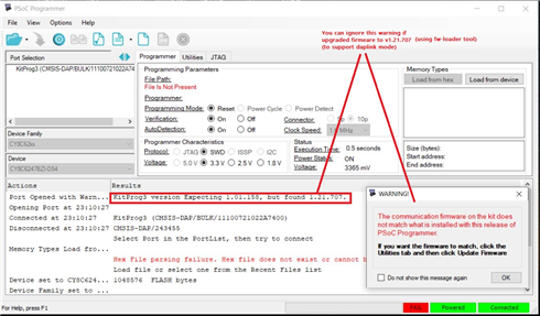

3. PSoC Programmer IDE
    Installer: PSoC Programmer 3.28.7.exe
   if you wish to play with code-example pre-build binaries then I would recommend installing this tool and no-other.
   You can't do any development, code-build, debug with this tool.
   if you have pre-build HEX binaries and wish to try run/execute then use this tool to program the Pioneer kit.
   Another important feature i like about this tool is you can toggle on/off the Pioneer Kit without having to remove/disconnect the USB cable (which power the Kit).
   This tool also show at what voltage the kit is config/operating in for e.g. 3.3V.
   Figure-1: PSoC Programmer after firmware update.
Use this tool to upgrade to Firmware v1.01.158, This firmware only supported modes kp3-hid & kp3-bulk.
kp3-daplink (also known as mass-storage) is not supported in this firmware.
To support daplink mode, use the fw-loader.exe tool to upgrade to Firmware v1.21.707 (supports mode kp3-hid/bulk/bootloader/daplink),
Pioneer kit must be (in bootloader mode) plugged-in via USB cable to the laptop/desktop when upgrading.

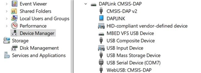

  • List of drivers shown in Device Manager
     Figure-2: daplink drivers for Mass Storage
Use the SW3 to switch between these modes kp3-bulk/hid/bootloader/daplink. If you are using fw-loader tool, make sure to close PSoC Programmer tool, otherwise the device will not be found.
Refer to this file "fw-loader(Guide).txt" as attachment to understand how to run fw-loader.exe tool to switch mode.
Refer to the file KitProg3 User Guide.pdf (section 7-Troubleshooting),
KitProg3 uses industry-standard CMSIS-DAP V2.0.0 and V1.2.0 as the Bulk and HID endpoints transport.
If your DAPLink drivers get messed up (as it did for me when unknowingly I installed mbedWinSerial_16466.exe drivers namely "mbed Composite Device" & "mbed Serial COM" as seen in device manager under DAPLink CMSIS-DAP). In order to fix such driver issues follow the troubleshooting steps and viola things were back to normal and using SW3 switch I could toggle between BUIL/HID/Bootloader/DAPLink endpoint modes.
If you see a yellow triangle against “CMSIS-DAP v2" and “WebUSB: CMSIS-DAP", it means that your drivers are messed up and more than one version of incompatible drivers are present. You need to find those incompatible drivers and remove/uninstall/delete it. For me I had installed mbedWinSerial_16466.exe and so had to uninstall and delete both "mbed Composite Device" & "mbed Serial COM".
Use winusbcompat.zip (5.55 KB) to manually install driver from Device Manager for “CMSIS-DAP v2" and “WebUSB: CMSIS-DAP". I shared this link because its hard to find them and not available in Microsoft site,
