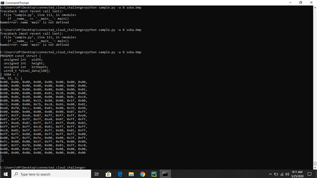

Image to BitMap C-Style Stream Conversion using Python :
As I have discussed in earlier Blog that After fetching Image from DataBase we need to convert that image into C streamable format for LCD display, After analyzing the input file and output file of Image to Bitmap Converter I have created my own code which can be deployed on Server and convert Image files into C-style streamable format.
My Python code to output a table of hex values representing the size and data from a .bmp graphics file.
- First we need to convert that Image (.png) to BMP (.bmp) format.
from PIL import Image
Image.open("sample1.png").save("sample1.bmp")
Right now my code is to convert that image based on Arguments passed via Command Line
Like
Sample.py [-i] [-r] [-n] [-d] [-x] [-w <bytes>] [-b <size-bytes>] <infile> <tablename>
# param raw "-r", bitmap written as raw table
# param invert "-i", to invert image pixel colors
# param tablewidth "-w <bytes>, The number of characters for each row of the output table
# param sizebytes "-b <bytes>, Bytes = 0, 1, or 2. 0 = auto. 1 = 1-byte for sizes. 2 = 2-byte sizes (big endian)
# param named "-n", use a names structure
# param double "-d", use double bytes rather than single ones
# param xbm "-x", use XBM format (bits reversed in byte)
# param version "-v", returns version number
Here is the sample code attached(not possible to paste here and manage) which I have used to convert the Image into Hex Table, In the future, we can modify code according to the needs. For the initial stage my needs Pre-Processed Image (Like Scaling, Crop, Invert, Version)

Output :
PROGMEM const struct {
  unsigned int   width;
  unsigned int   height;
  unsigned int   bitDepth;
  uint8_t *pixel_data[160];
} SOBA = {
40, 32, 1, {

    Jan Cumps over 6 years ago
    sami9974, the attached sample.py seems to be the one that has the "name 'main' is not defined" error.
  • sami9974
    sami9974 over 6 years ago in reply to Jan Cumps
    Can you check now, I have corrected the Python file.
