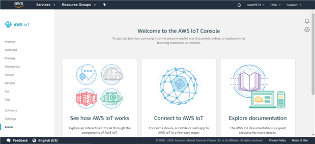

Now that you are logged in, head over to the AWS Management Console, At the top, click Service and scroll down until you see the Internet of Things on the right-hand side Click on IoT Core.
On the left-hand side. Click Manage, and then click Create in the upper right, choose "Create a single Thing" and then give it a name. You can safely ignore everything else on this page for now.

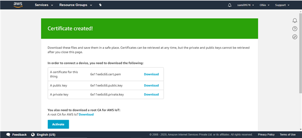

The next page shows certificate creation options. AWS IoT is only accessible via TLS, meaning we have to deal with private keys and certificates. If you were starting from scratch, this would quite speed bump. but luckily mbed and Cypress have provided excellent example code and libraries. Choose the top option, One-click Certificate Creation.
Super important note: The next page that shows up will only ever be shown once, as a  security measure. Make sure to download all three files: certificate, the public key, and private key. After you have downloaded them, click the Activate button.
Next is a super-important step that I skipped when I first started to work on this project, and it caused me hours of headaches thinking something completely different was wrong. Click Done, which should take you to the details page for your newly created Thing. Click the grey arrow in the upper left-hand corner.

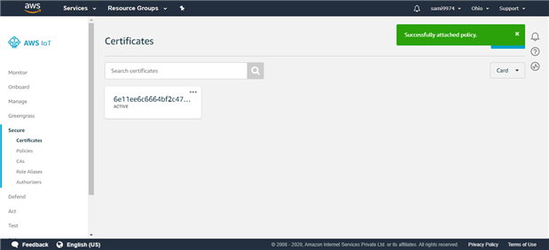

Now we need to create a policy and attach it to the thing we just created. On the main Core page, click Secure in the Left-hand side menu, This will open sub-menu where you see the certificate we just created. Below certificates, Click on Policies and then click Create in the upper right. Give it any name ("testPoilicy" which I have given). In the statements section below the name, enter iot* as the action and  * as the resource ARN. check-off Allow, and then click create the bottom right.
Now go back to the Certificated sub-Menu and click the 3 dots in the certificate box. Choose Attach Policy, check off the policy we just created, and click Attach. Now we are finally ready to cloud.
