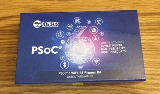

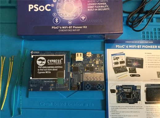

4. What's in the box
  • PSoC 6 WiFI-BT Pioneer Board
  • CY8CKIT-028-TFT Display Shield
  • USB Type-A to Type-C cable
  • Four jumper wires (four inches each)
  • Two proximity sensor wires (five inches each)
  • Quick Start Guide
[PSoC 6 WiFI-BT Pioneer Board]
5. About the PSoC 6 WiFI-BT Pioneer Board
The PSoC 6 WiFI-BT Pioneer Board uses an Arduino (Arduino UNO R3) form-factor baseboard.
Note: If you are new to working with electronics, the purpose of using a starter board like this one, is that it provides the solutions designer a quick way to prototype solutions without having to go through the trouble of soldering / wiring up the module itself.  In addition to the ambient light sensor, user push buttons and other various sensors, you can use the Arduino form-factor shield expansion connector and other ports to quickly wire up additional sensors and inputs.  Once the design is complete, you or your organization would then purchase and hard wire / solder the module for your production solution.
Features:
The PSoC 6 WiFi-BT Pioneer Kit features the PSoC 62 MCU: a single- or dual-core MCU, with an ArmRegistered CortexRegistered-M4 and ArmRegistered CortexRegistered-M0+, 1MB of Flash, 288KB of SRAM, 102 GPIO, 7 programmable analog blocks, 56 programmable digital blocks, Full-Speed USB, a serial memory interface, a PDM-PCM digital microphone interface, and industry-leading capacitive-sensing with CapSenseTm.
