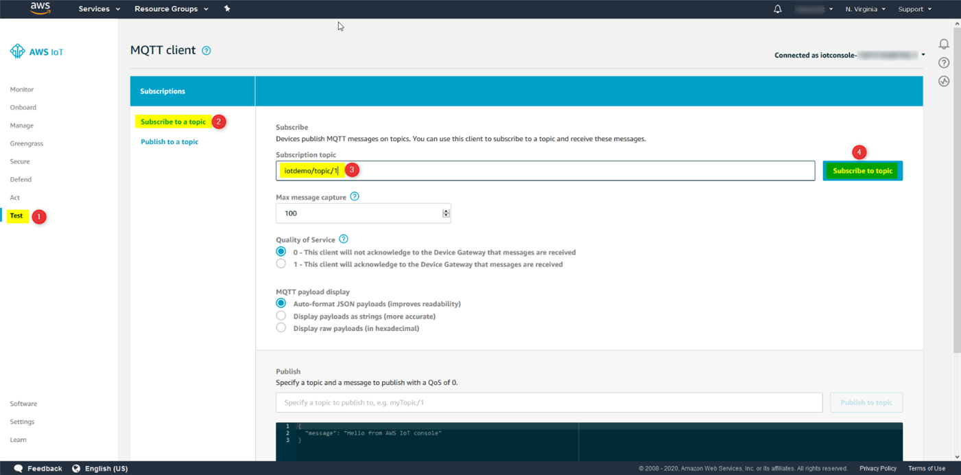

Here's what you need to do. We can use AWS IoT's quick test capability as shown below. Browse to AWS IoT Test tab, click on Subscribe to a topic tab and type iotdemo/topic/1 as a Subscription topic, then click Subscribe to topic button. As described in Getting Started with Amazon FreeRTOS and PSoC62 + 43xxx, the AWS demo application "publishes messages on four different topics (iotdemo/topic/n, where n=1 to 4) and subscribes to all those topics to receive the same messages back."
Repeat the above steps to subscribe to topic 2 to 4. After you subscribe all four topics described above, your screen should look like this screenshot.

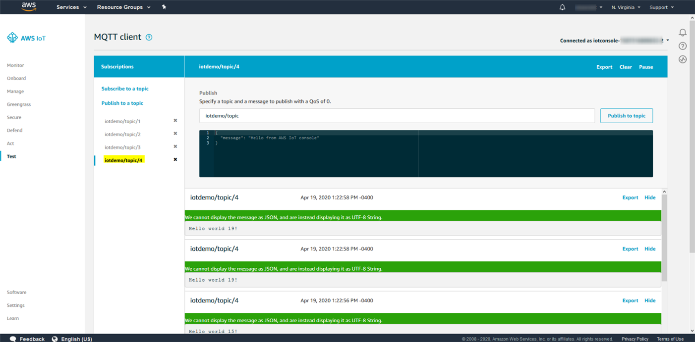

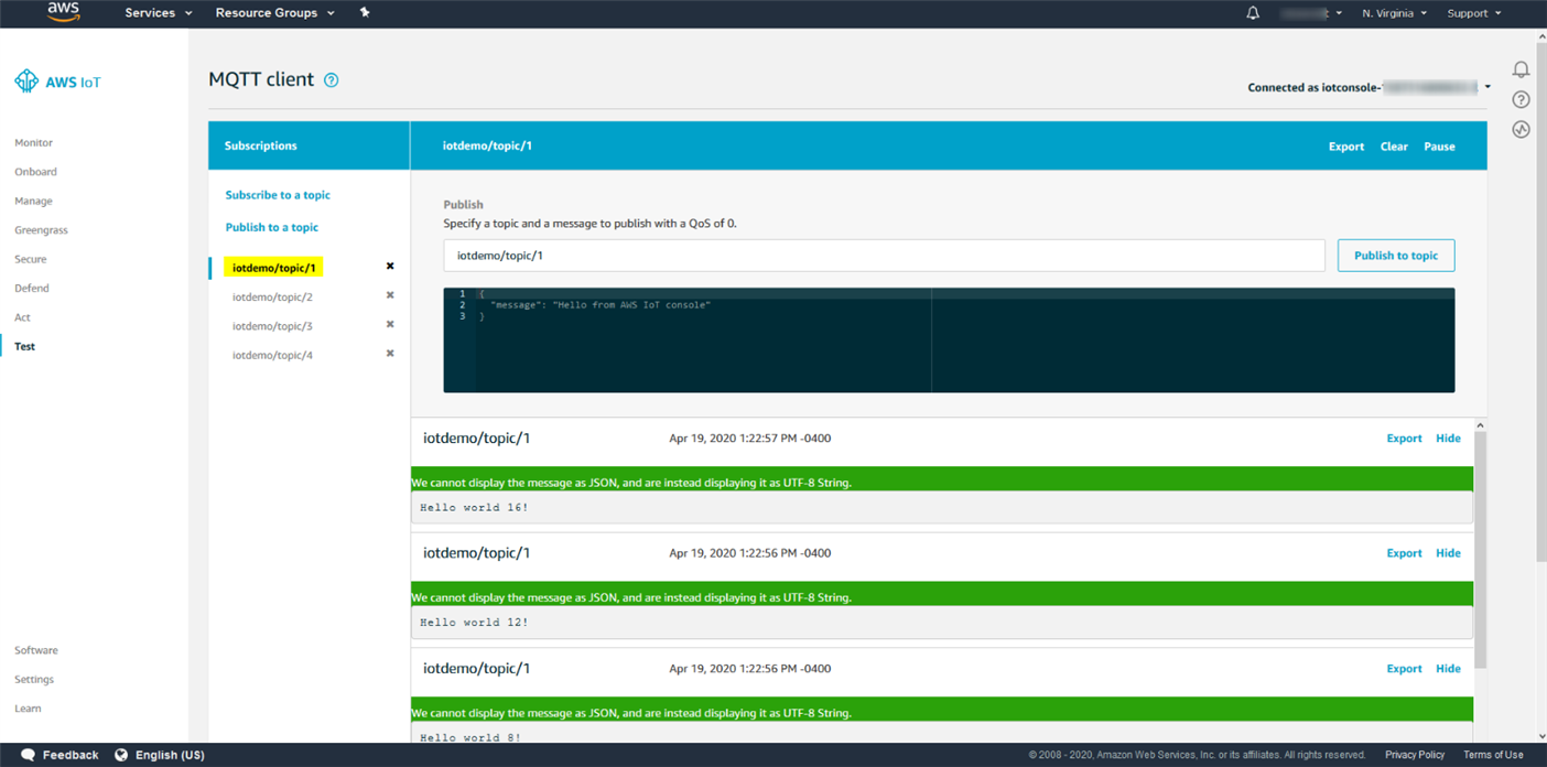

Now, you can power up your pioneer kit board. After a few seconds, you should see some messages shown on each topic (topic 1 to 4) you subscribed before. Here's two example screenshots showing the messages have arrived on the AWS server.
