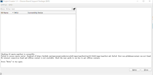

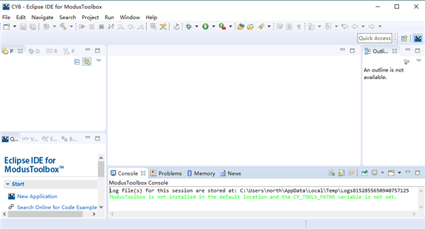

1. As always, the Suggested IDE by vendor is best one. Easy download and installtion as follows with Modus Toolbox
2. While the Project-creator can  not work well,
The XML file can not be fetch.
Checking if remote manifest is accessible...
Failed to access remote server: Download of https://github.com/cypresssemiconductorco/mtb-super-manifest/raw/v2.X/mtb-super-manifest.xml failed: Host raw.githubusercontent.com not found
No internet connection found and offline content is not available. Check the user guide to see how to get offline contents.
Press "Retry" to try again.

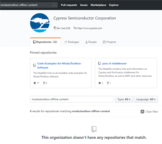

3. Follow the user guide, I search the modus toolbox homepage and github page,
Still can not find the Offline file. This is one small bug, need to fix later.

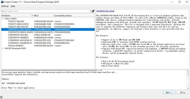

4. Anyway, Mbed OS is evolved into OS version 5. I have tried with online compiler version. Next, Mbed CLI would be tested in next blog. Things change, the xml file is accessible later.
New project is created.
Summary:
BSP: CY8CPROTO-062-4343W
Template Application: AnyCloud MQTT Client
New Application Name: SmartFridge
Location: D:/MyProjects/SmartFridge
Press "Create" to create "SmartFridge" application.
Project creation command to be executed:
D:/ProgramData/ModusToolbox/tools_2.1/project-creator/project-creator-cli.exe --board-id CY8CPROTO-062-4343W --board-uri https://github.com/cypresssemiconductorco/TARGET_CY8CPROTO-062-4343W --board-commit latest-v1.X --app-id mtb-example-anycloud-mqtt-client --app-uri https://github.com/cypresssemiconductorco/mtb-example-anycloud-mqtt-client --app-commit latest-v1.X --user-app-name SmartFridge --target-dir D:/MyProjects/SmartFridge --output-for-machine --use-modus-shell
