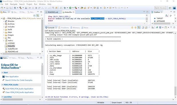

1. After installation of Modus Toolbox, create project is easy. First, start Project-creator in Tool Directory, choose the sample project and import into project directory.
One important setting shall be made before build process, in system parameters,CY_TOOLS_PATHS
CY_TOOLS_PATHS
D:/ProgramData/ModusToolbox/tools_2.1
The backslash shall be revised accordingly in Linux-like format,or the Modus Toolbox still can not find the Tools.
2. Use PDM-PCM_Audio as example, the output shows full information in cluding memory allocation.
3. The whole UI is familiar to most Eclipse Users. Most Vendor-specific toolset use Eclipse, CCS for TI, MCUexpress IDE for NXT, and CubeIDE for ST. Therefore, quick-getting-start makes developers focus on the codes.

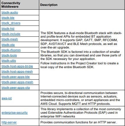

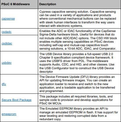

Middleware includes libraries that implement an API for a particular domain, for example capacitive sensing or an http server. A middleware library may be created by Cypress or come from a third party. Cypress-created middleware may use the Cypress HAL or an LLD directly. In that case, you need the corresponding driver library or BSP for the middleware to work.
low-level driver (LLD) contains the API and source code to configure and use a feature or peripheral on a device. ModusToolbox provides the Peripheral Driver Library (PDL) for PSoC 6 devices, or the Wi-Fi Host Driver (WHD) for CYW43xx connectivity devices. Device-specific source code and header files are included in the LLD.
In addition, Cypress provides a hardware abstraction layer (HAL). You can use the HAL for most hardware configuration.
