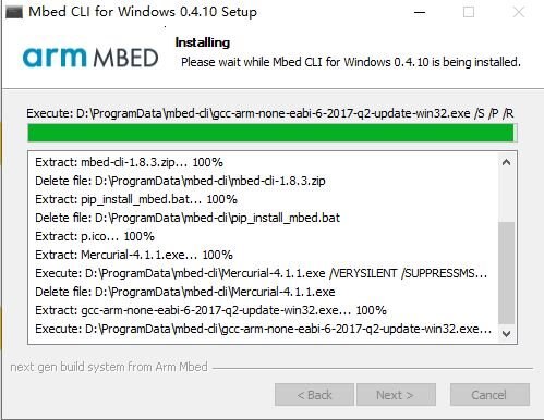

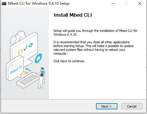

1. Install mbed-cli.msi in Windows 10
with the fowllowint components,
The python 2.7.10 is installed and ruin my previous python 3.6.x ENV. I have to reinstalled python 3.7 in anaconda ENV in isolated environments. It is  suggested to install Mbed CLI from within a virtual environment and run all commands from within your virtual environment.  Other lib includes git. mercury, arm-gcc...

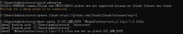

Then install pyocd , update libusb https://github.com/libusb/libusb/releases/tag/v1.0.21  properly.
pip install -U pyocd
After you install pyOCD via pip or setup.py, you will be able to execute the following in order to start a GDB server powered by pyOCD:
pyocd gdbserver
To use the GCC 7.2.1 distribution bundled with ModusToolbox, run the mbed config command as appropriate for Windows :
mbed config -G GCC_ARM_PATH ~/ModusToolbox/tools_2.1/gcc-7.2.1/bin

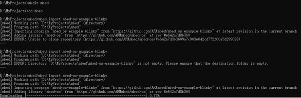

Then,
mkdir mbed-examples
cd mbed-examples
mbed import mbed-os-example-blinky
cd mbed-os-example-blinky
mbed compile --target CY8CPROTO_062_4343W --toolchain GCC_ARM
mbed export -i eclipse_gcc_arm -m CY8CPROTO_062_4343W
Finally, the exported project can be imported into Modus Toolbos for further steps.
