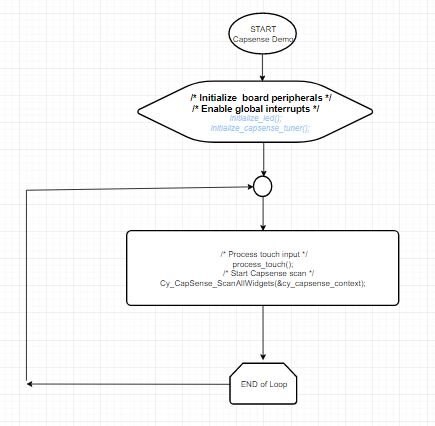

3.1 Capsense in loop polling,
Normal coding is as flows,
The main part is attached for reference,

    /* Start first scan */
    Cy_CapSense_ScanAllWidgets(&cy_capsense_context);
    for(;;)
        if(CY_CAPSENSE_NOT_BUSY == Cy_CapSense_IsBusy(&cy_capsense_context))
            /* Process all widgets */
            Cy_CapSense_ProcessAllWidgets(&cy_capsense_context);
            /* Process touch input */
            process_touch();
            /* Establishes synchronized operation between the CapSense
             * middleware and the CapSense Tuner tool.
            Cy_CapSense_RunTuner(&cy_capsense_context);
            /* Start next scan */

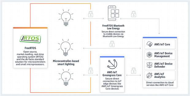

4. FreeRTOS with AWS IoT
As in https://aws.amazon.com/freertos/?nc1=h_ls , FreeRTOS provides everything you need to easily program connected microcontroller-based devices and collect data from them for IoT applications. You can get started by choosing a FreeRTOS-qualified microcontroller from the AWS Partner Device Catalog.
The following diagram shows how FreeRTOS is important to AWS IoT. Normal polling can make it but not so secure and reliable.
FreeRTOS core handle stacks, thread-management, memory allocation and destroy, each of which is challenge to coding.
But , now it is safe and easy. use combination of two lines, it will go fine.
