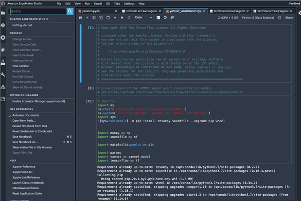

Amazon SageMaker
Amazon SageMaker is a service provided by AWS for run of Machine Learning, the platform provided easy of use tools for build of Machine Learning such as the SageMaker Autopilot running inside new Amazon SageMaker Studio for general data analysis, on the other hand, it also flexible to run custom tasks as specific the run machine and kernel allow install custom modules and git repository.
We first to study run under Amazon SageMaker Studio which provide Autopilot to automate model build, however it only accept csv good for business data analysis but not good for this job require analysis wavform, so we train our model by custom python script inside SageMaker Studio.

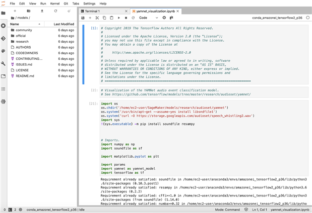

In additional, SageMaker Studio also not allow access by external web socket, which we could like to trigger the recognising jobs automatically, so we shift to use SageMaker Notebook instances, which allow us build of model and run of predict and connect outside by websocket inside a virtual machine.
We creative a new Notebook instances with import the Git repositories https://github.com/tensorflow/models
The Notebook instances similar the Studio also run on top of Jupyterlab.
We active the Conda Environment tensorflow_p36 which pre-installed Tensorflow:
source activate tensorflow_p36
We also install additional lib: resampy, pysoundfile and libsndfile.
conda install -c conda-forge resampy
conda install -c conda-forge pysoundfile
conda install -c conda-forge libsndfile

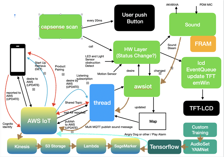

Conclusion
By using Amazon SageMaker and Lambra function, we are success to received sound clip pick from Cypress Pioneer Kit PDM's Mic to recognise Angry Dog sound and feedback to Cypress Pioneer Kit's Internal Sound Card to play the alarm all though AWS Cloud.
Our final IOT platform is:
