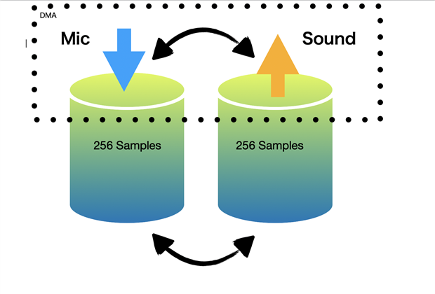

BUFFER
We use two small buffer, each with 256 samples, one for playback, another for record, after each cycles, role of buffer will fliping to provide continue sound steam.
The DMA will trigged interrupt after finish read 256 data, and we start another cycle by change of Dsc/Src Address of DMA.

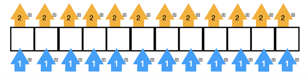

The CPU with two separate DMA direct memory access, our echo use both of them, which DM1 for Mic input and DM0 for codec, we also use the interrupt DMA to flipping the record and playback buffer. The I2S require stereo signal, we use 2D DMA at codec TX DMA, which every address will read twice before shift to other.
Based on the timing for PDM Mic we selected MONO LEFT input, as I2S require Left/Right signal,  just every cycle DMA Codec read some address twice for duplicate left and right. The Mic DMA just write once, the DMA run all those process without use CPU resources.
The descriptor help us to play with that, for PDM input, simple 1D Xincrement 1 and xCount set to 256, as PDM config .chanSelect CY_PDM_PCM_OUT_CHAN_LEFT only Mono data will feed to  buffer for save memory.
The descriptor of I2S we config to 2D srcXincrement set 0 and xCount set to 2 to stand some address twice, and outer (Y) loop srcYincrement set 1 and Count to 256 to feed both left/right some samples.
We also set trigger type to CY_DMA_DESCR, so after each descriptor finish we have chance for change of address.
Because we only need change the dsc/src address between every descriptor, very low overhead is require for background playback, as this is the reason why DMA save CPU time and power.
