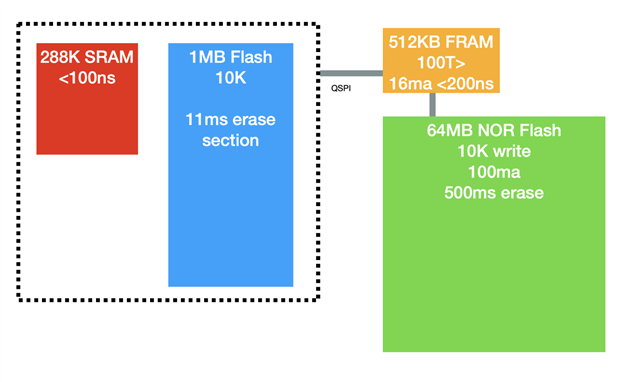

Our main program area, only have 288K SRAM for program usage included the global variance, heap and stack, in our current software, our program  data + bss require 136kb, so we only have 140kb for heap+stack usage, the LCD UI use about 32kb, the WHD (WIFI driver) + AWS use almost 50kb with additional 10kb for other, we almost use near all of our SRAM, with no room for storage sound buffer, we need immediate transfer the PDM Mic data to external memory.
Under our kits, we have four devices of memory, which are SRAM and Internal Flash, also with 512KB FRAM and 64MB Flash connected by QSPI.
In our application, we use 16khz 16bit mono data, which 32KB/S, if we use all 64MB flash, we can store 2048S in a cycle, as 10K write cycle, we got 237 days out of life, also it write speed is relative slow, we require big SRAM buffer, which we can not afford.
FRAM
The FRAM is our solution, the Ferroelectric Random Access Memory is new type of non-volatile with very long endurance, very high speed and don't need erase before write, although it very expensive but cheaper that SRAM, make it good for using critical environment which require instant record, the FRAM give us at least ten thousand years record time, although current FRAM size very small, the 512KB FRAM can only record 16s, this enough our usage.
As the FRAM don't require slow block erase before write and don't require additional wear levelling process, as this latency fix and low, the power consumption of every write can be very low and don't require additional power loss protection circuit and backup battery, make this very suitable for IoT use, as many IoT frequency write small logging such as sensor data. As it very fast writing time, it can be faster return to sleep idle reduce the overall power consumption.
From the view of programming, it also reduce complex of software, as the status can save it instantly, quick and high endurance, no additional power loss recovery logic and verify is required.
The reason is amazing, our system only require 256 Bytes small buffer for record and playback under SRAM, as both of DMA is using by WIFI, as our experiment, the record/playback will affect the network, which make AWS jobs unstable, it is because the DMA is share for both Sound and WIFI SDIO. In here, we shift using traditional interrupt method for record and playback, because FRAM speed very high, as such small buffer size, we able working for AWS task, update LCD, logging sensor without destroy the playback or record.

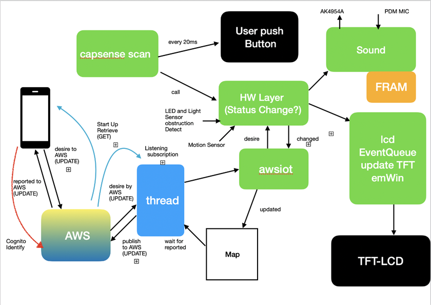

Control of Sound Recorder
hw.cpp received AWS/Capsense user inputs, after that the hw.cpp will call sound.cpp change of relative status var.
The main thread will call sound_update every 20ms, the sound_update track any change, check and working relative process.
The User can control the recorder either from IOS APP though AWS IoT or Capsense, use the indirect control method mainly for prevent deal loops issue,
also ISR is limit on Mbed, for example ISR is not allow mutex.
The slider is using for volume control can be adjusted though AWS or by Capsense.
