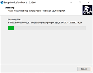

i downloaded IDE  2.1 and during installation i change the default installation directory to e:
as my c drive is becoming crowded.

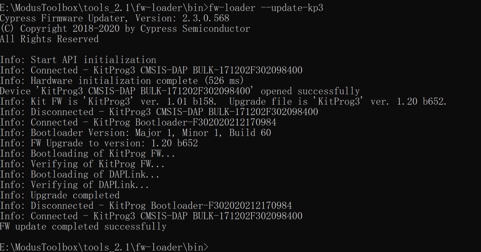

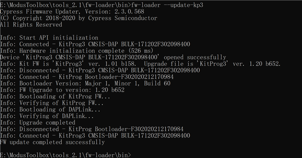

i did a firmware update with the modus IDE installed firmware loader. Latest firmware is at here though i only use the version that comes with Modus IDE

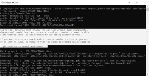

clone it with this release
https://github.com/cypresssemiconductorco/amazon-freertos/releases/tag/201910-MTBAFR1951
eg. git clone --recurse-submodules https://github.com/cypresssemiconductorco/amazon-freertos.git --branch 201910-MTBAFR1951
what does 'detached head' state means? >>> look at this https://www.git-tower.com/learn/git/faq/detached-head-when-checkout-commit

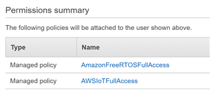

we then need to set permission on Amazon, and adding these two permissions to the user

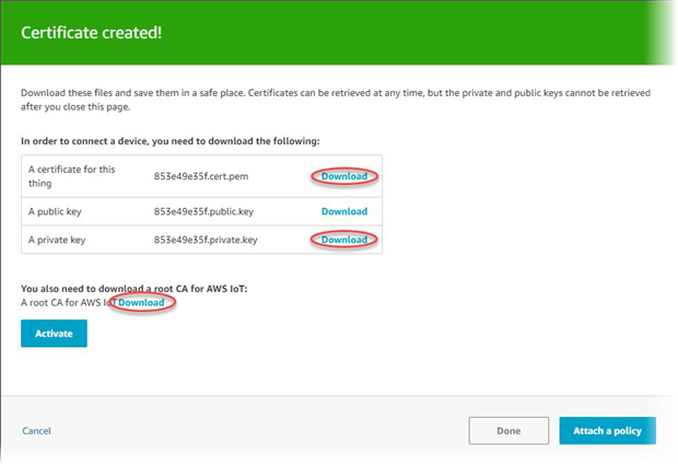

i copy this figure from https://docs.aws.amazon.com/iot/latest/developerguide/create-device-certificate.html
but i only downloaded the certificate, the public and private key. i not successful download the root CA for AWS IoT
however, i find myself without the need to use the root CA for AWS IoT

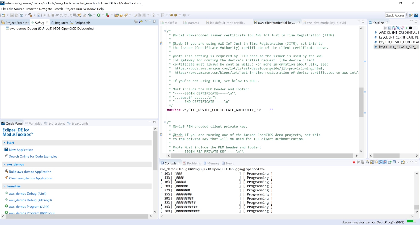

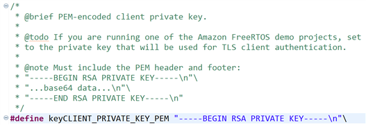

after registration, remember to edit the aws_clientcredential.keys.h files following this instruction
here is screenshot how to set the key
where we set the endpoint  ,the thing , the wifi credential as well as connection type

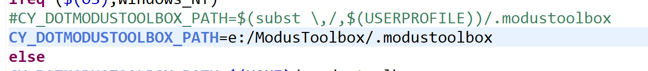

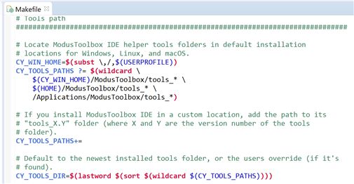

Special Note on my machine: i do encounter a build error on Modus as it can't find some tool at its default c drive. i got to manually fix it by pointing to my install directory
in the makefile
also, start.mk has to be modified as it cannot handle white spaces

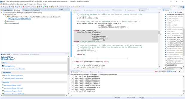

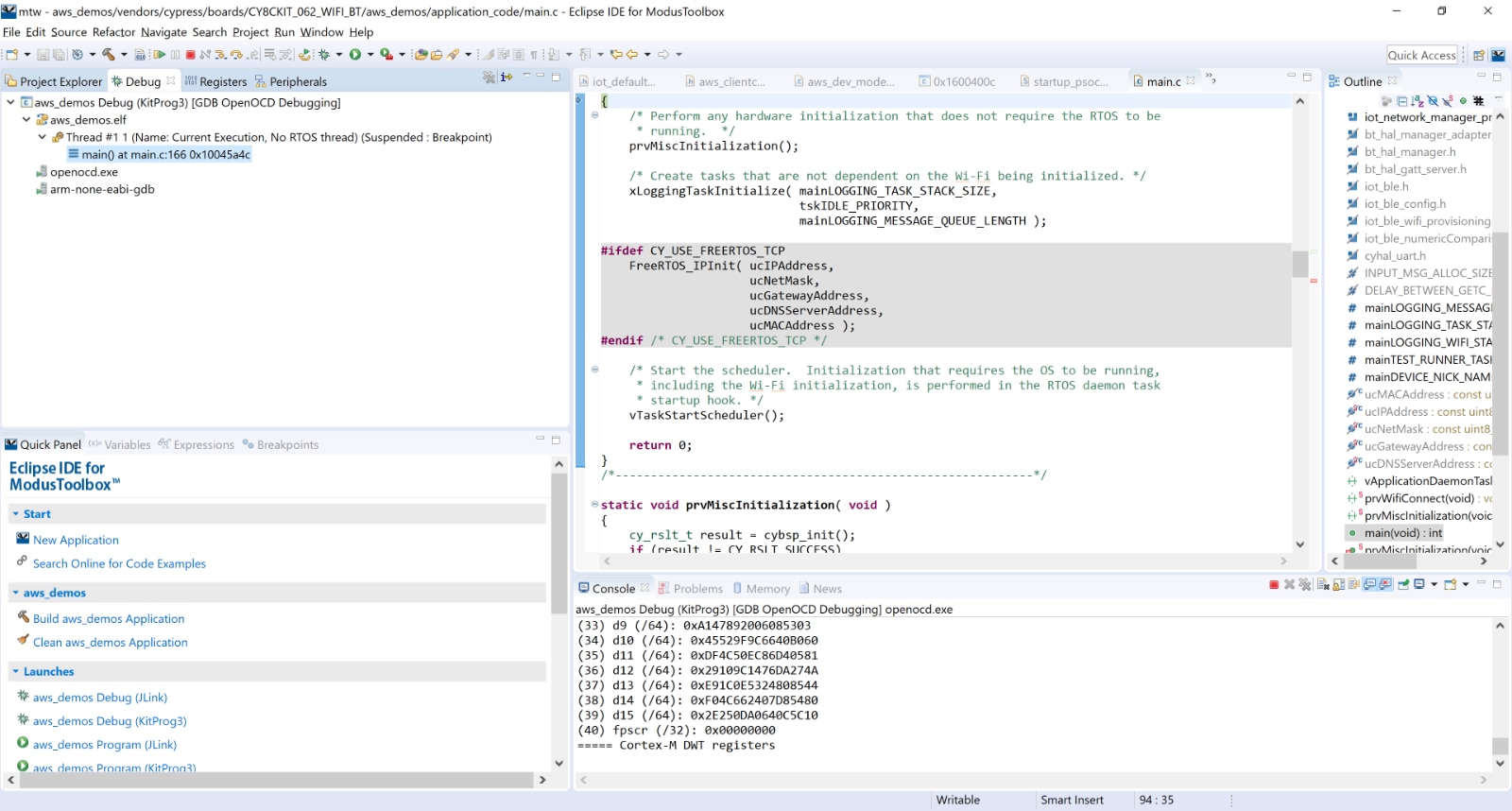

Then, we build and download the code, by clicking aws_demos Program (KitProg3) in the quick panel
Figure sreenshot during programming

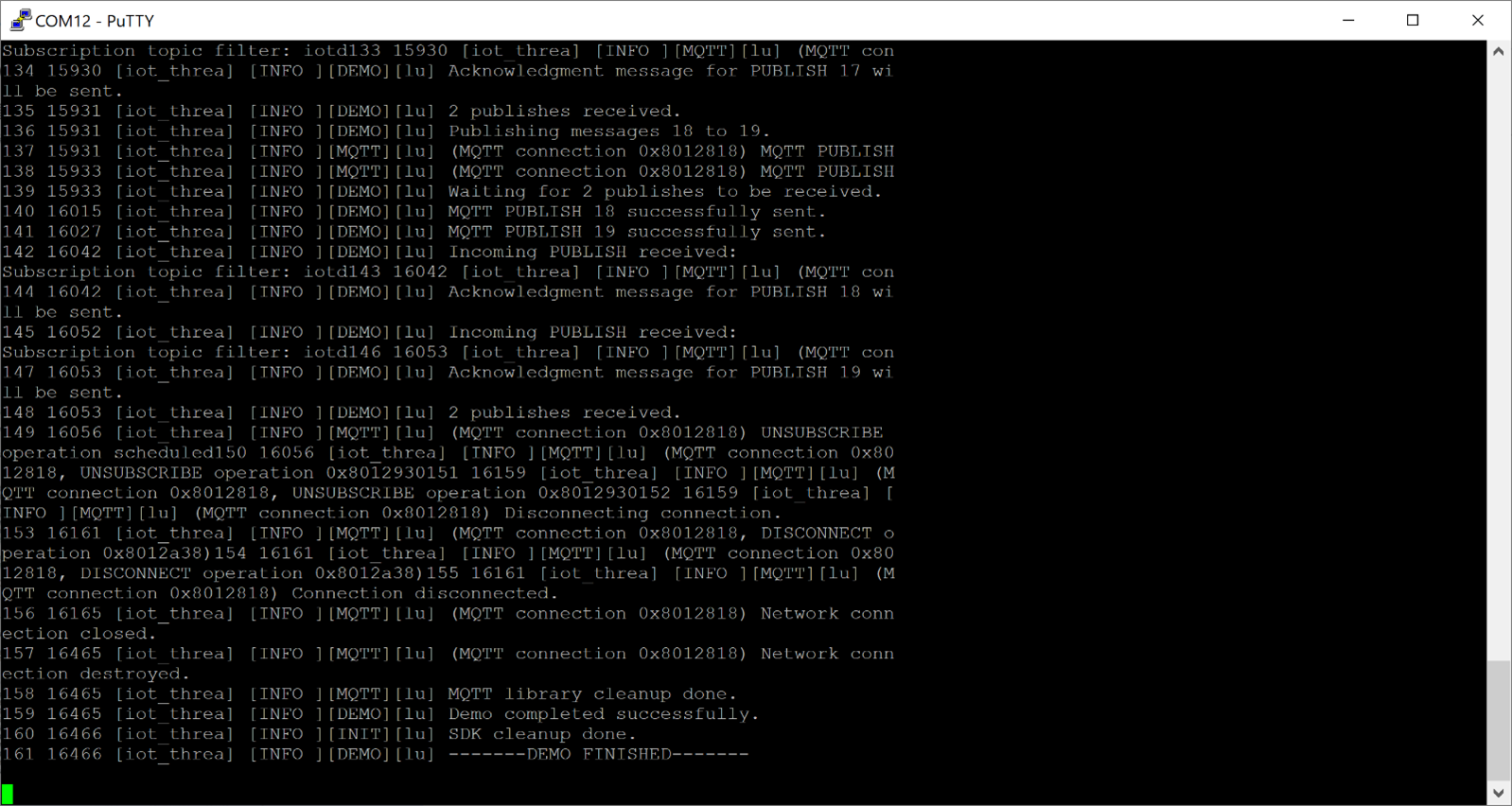

Figure screenshot after programming.
from here we can click the resume button on toolbar, and on putty terminal we will see its response
