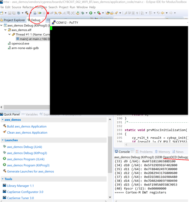

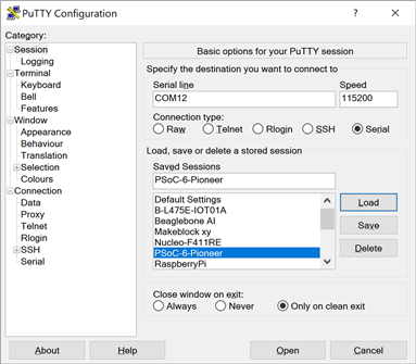

after we successfully run the debug via kitprog3, we will use putty (below is my settings)
It will shows this output, where the thread is suspended

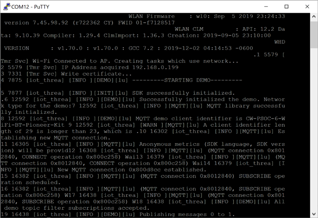

after we click resume, we will see the output
