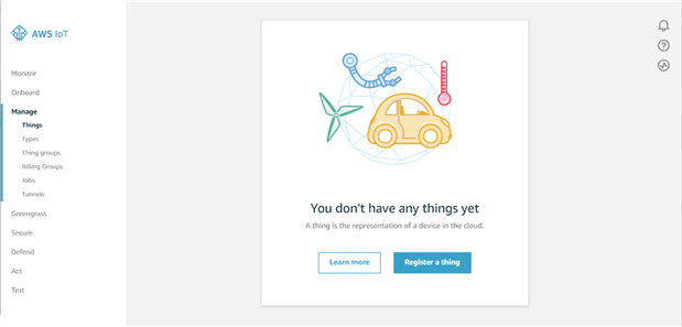

To create a Thing I selected from the left menu "Manage-Things":
Then I pressed "Register a thing":

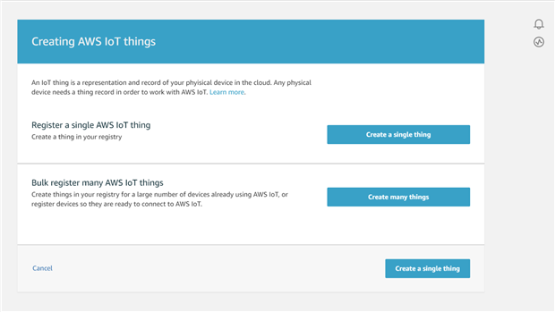

Here I can select if I want to create a single Thing or many Things. The IoT Core service supports handling billions of devices and many bulk operations, such as creating many things, but as expected, handling large amount of devices is quite more challenging than handling them individually. I pressed the "Create a single Thing" button:

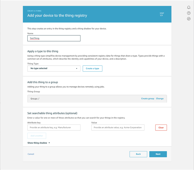

I called my thing "TestThing". The Thing type is a classifies the Thing, each Thing can be classified only as one Thing type (ie: "SmartCage"). Things can also be grouped (ie: "PSOC6") in as many as 50 groups. Attributes are properties of the devices (ie: "serial number"). Then finally we can set the shadow, which is a special MQTT topic that a Thing can use to notify its current state (or the last state before getting disconnected) to AWS services or other devices, and also allow AWS services to send messages to the device. To make debugging easier its always a good plan to keep things as simple as possible, so I just pressed next without setting anything else but the name of the Thing:

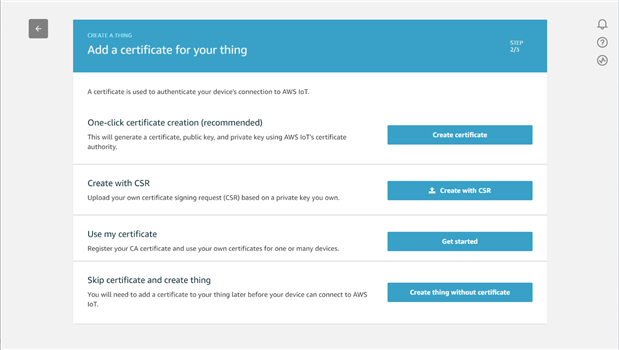

To connect to the AWS MQTT broker I need a certificate, a private key and a root CA. The simplest solution is to let AWS create them by pressing the "Create certificate" button:

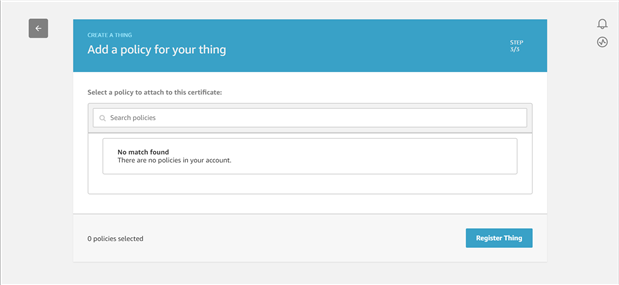

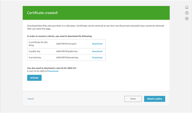

These files can only be downloaded while the page is open, if they are not, a new certificate will have to be created, or otherwise the device won't be able to connect to the MQTT broker. The device requires 3 files to connect to the broker: the Thing certificate, the private key, and the root CA. After downloading the files I activated the certificate by pressing the "Activate" button, then I pressed the "Attach a policy" button:
Policies define the certificate access permissions to MQTT topics, but as I didn't have any policy, I pressed "Register Thing" to complete the Thing creation process.

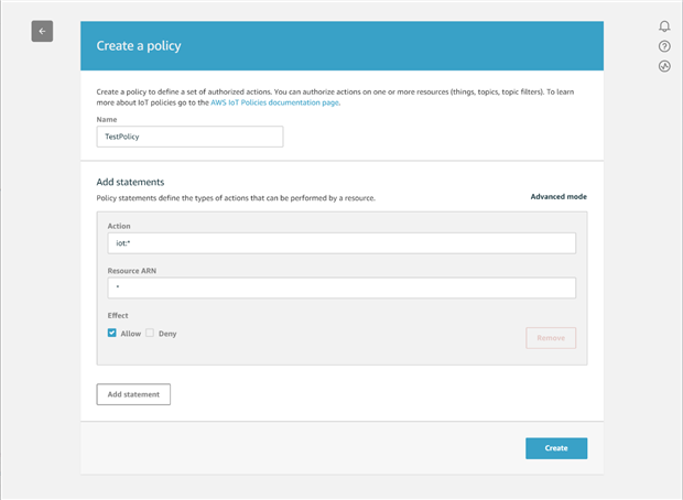

Now I needed to create a policy so that the device could connect to the MQTT broker. Policies are attached to certificates which are attached to Things. Ideally each Thing should have its own certificate, but policies are usually shared by many Things.

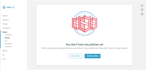

To create a policy I selected "Secure-Policies" from the left menu:
And pressed the "Create a policy" button:
Policies specify the permissions to access MQTT topics, and should be as restrictive as possible, but for debugging purposes I'm gave the policy full access to all MQTT resources. I pressed "Create" and the policy got created.

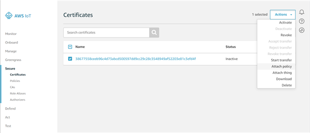

To attach the Policy to the certificate I selected "Secure-Certficates" from the left menu:

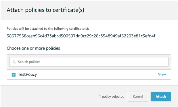

Marked the certificate (which I created while creating the Thing), pressed the "Actions" button and then "Attach policy":
I marked the "TestPolicy" policy and pressed Attach.
