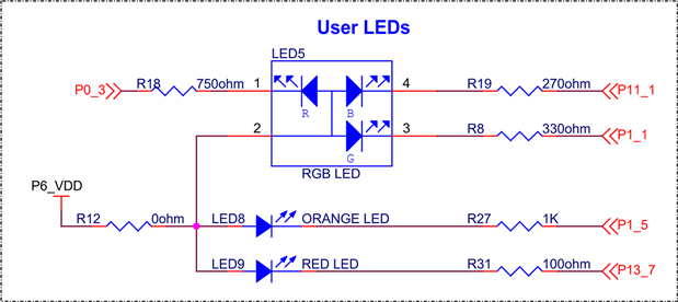

To get started with Mbed I began programming a non-trivial but not complex LED library. The Pioneer PSOC6 board contains 3 user programmable LEDs: an RGB LED, an orange LED and a red LED.
The source code runs 2 threads: main() and ledThread(). main() controls the LEDs by sending messages, through an Mbeds' Queue object, to ledThread(). LEDs can operate in 3 different modes: on or off, oscillating and pulsing. The program is made of 3 files:

The board looks like this when running the code:
