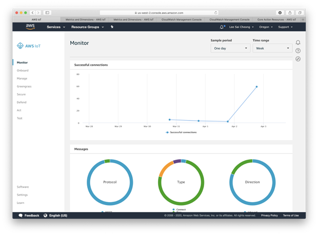

The Mbed serial console output:
Connecting to the network using Wifi...
--- [RESET] ---
START DEVICES...: Success
WLAN MAC Address : CC:C0:88:AA:9E:AA
WLAN Firmware    : wl0: Sep  5 2019 23:24:33 version 7.45.98.92 (r722362 CY) FWID 01-f7128517
WLAN CLM         : API: 12.2 Data: 9.10.39 Compiler: 1.29.4 ClmImport: 1.36.3 Creation: 2019-09-05 23:10:00
WHD VERSION      : v1.70.0 : v1.70.0 : GCC 6.3 : 2019-12-02 04:14:53 -0600
num of wifi: 7: Success
IP: 192.168.1.139 : Success
Connected to the network successfully. IP address: 192.168.1.139
connected to AWS : Success
Connected to AWS endpoint
Success
publish to AWS successfully: Success
Published to topic successfully
Success
Success
Success
Success
Success
The AWS console output
What Next
The next step is improve the reliability of WIFI, and try to triggering the iOS APP (Device button > AWS Cloud > APP )
