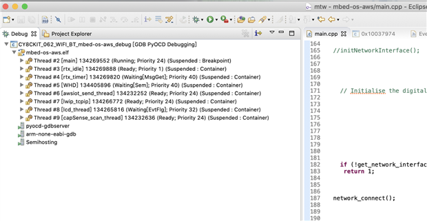

Mbed RTOS
Mbed included a well threading managing under RTOS which simplified our work.  The system create server thread such as rtx_idle/rtx_timer. The WIFI driver and Network Interface also create their threading.
The main thread is the start thread of the Mbed program.

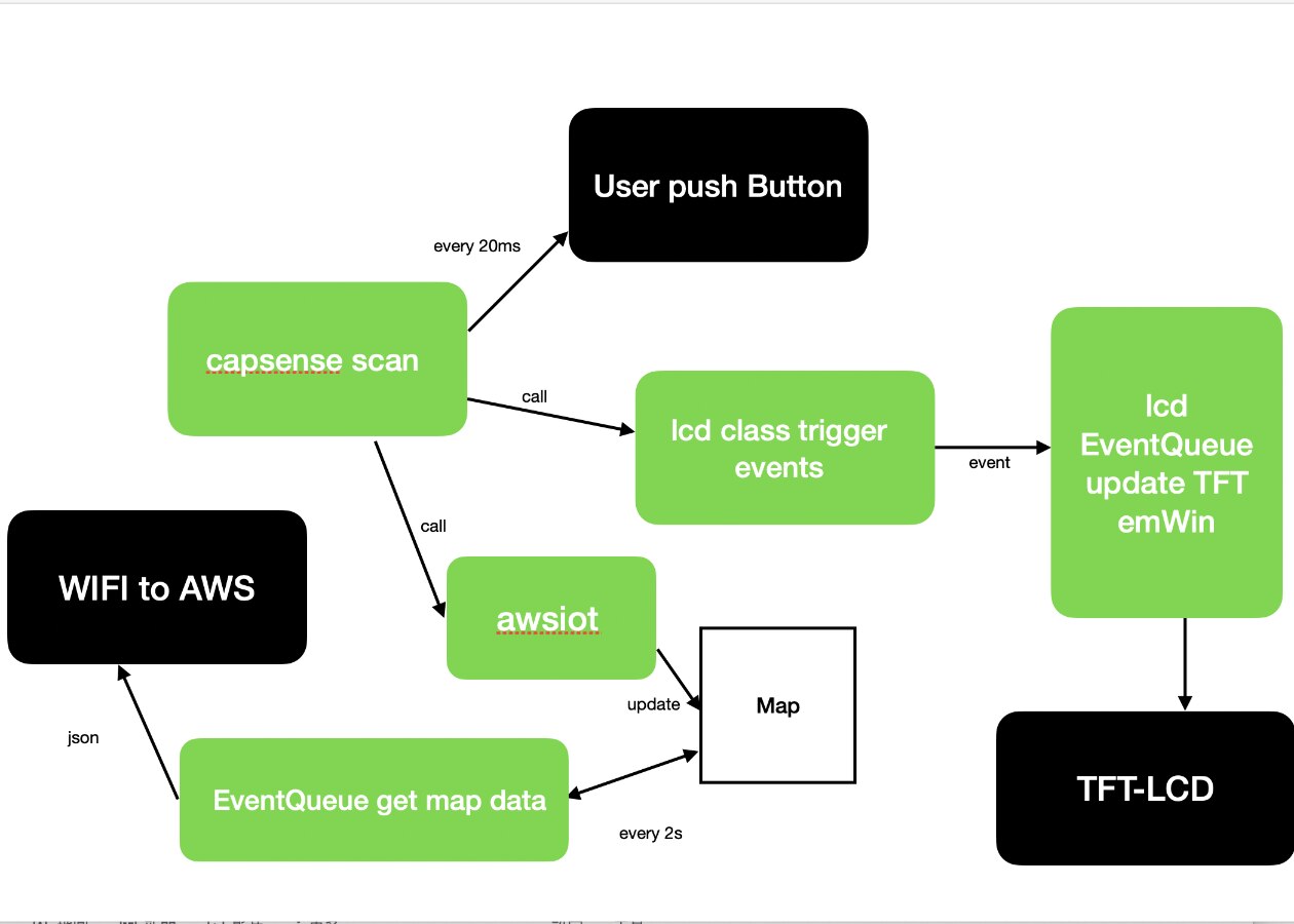

Our program create additional threads for:
1. CapSense  - scan cypress CapSense touch buttons/sllider every 20ms control by EventQueue capsense_queue run under capsense_thread
2. AWSIOT - run every 2 second control by awsiot_queue run under awsiot_thread, for send the data to the AWS server.
3. LCD - The lcd_queue wait task for update LCD Display with size 16, and rejected additional task if  more that 16 drawing jobs waiting.

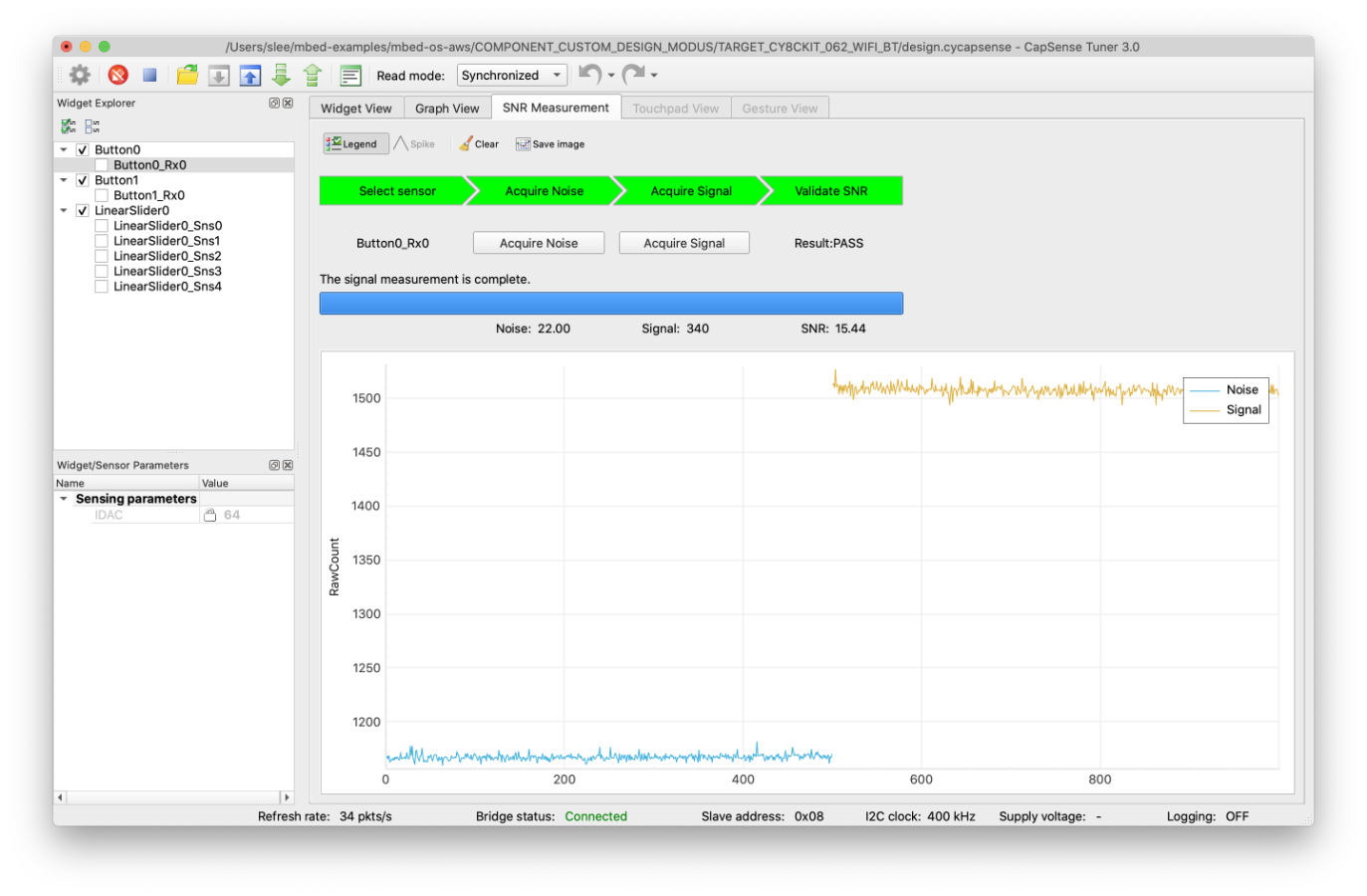

Capsense
By reference of Cypress example of https://github.com/cypresssemiconductorco/mbed-os-example-capsense  and use of capsense-configurator is easy of enable of Touch buttons and sliders.
The CapSense Tuner also is helpful for troubleshooting and validate the touch function.

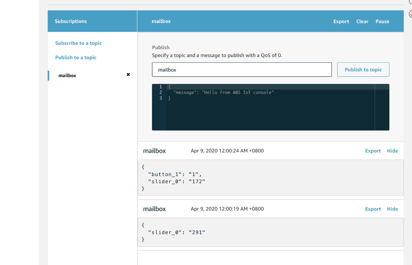

Send to AWS IOT
The process from User pushed to AWS is:
1. User push button
2. capsense scan every 20ms
3. lcd_ui received capsense call and build event tasks for update lcd
4. lcd EventQueue work jobs based on FIFO, however some tasks will run by delay such as clear text after one seconds for the short notifications.
5. awsiot received capsense call and write key and value to a c++ map.
6. awsiot EventQueue read the map every two seconds, if the map empty, the event close immediately, otherwise the event build json string and publish to AWS cloud.
    finally clear the map
