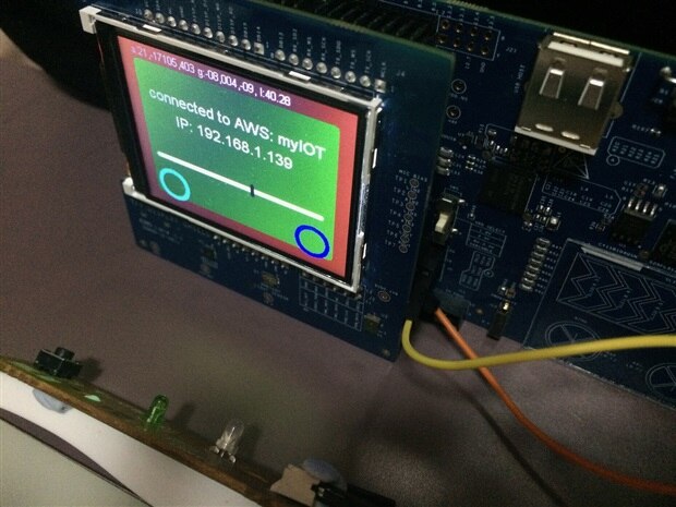

Sense the Mail
We use this ALS to sense the obstruction, such as the mail, based on
https://www.vishay.com/docs/81579/temt6000.pdf
best use of green LED for highest sensitive.
We connected a LED to 13_6 GPIO and set DigitalOut ext_led for this pin.
  hw_read_als();
  float pre_no_ext_led_lux = lux;
  ext_led = 1;
  wait_us(3000);
  hw_read_als();
  float ext_led_lux = lux;
  ext_led = 0;
  wait_us(5000);
  hw_read_als();
  bool prev_hw_with_mail = hw_with_mail;
  if (abs(ext_led_lux-lux)>50 && abs(ext_led_lux-pre_no_ext_led_lux)>5&& abs(pre_no_ext_led_lux-lux)<20)
  hw_with_mail = false;
  else
  hw_with_mail = true;
We use flash approach to detect the mailbox with or without mail
1. We check brightness before flash LED
2. We switch on LED and with 3ms
3. We check brightness
4. We close on LED
5. Recheck brightness after 5ms
If the LED on brightness is higher that 50 of first and last without LED measure, and the first and last without LED measure different less than 20, mean that the mail inside mailbox and obscure the light.
The detect good enough with the mailbox thickness < 7cm.

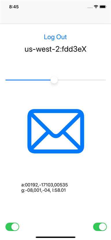

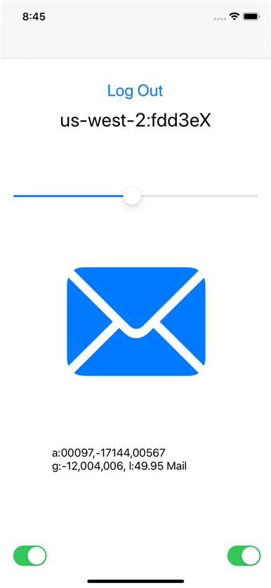

Connect With AWS IoT
We are enhanced our iOS APP and AWS IoT shadow facility, so that the APP able to received is any mail inside mailbox.
We can also pass the motion sensor data to iOS for additional debug information.
