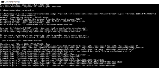

  1. I’ve cloned  Amazon FreeRTOS from Cypress’ GitHub repository with demo projects.
git clone --recurse-submodules https://github.com/cypresssemiconductorco/amazon-freertos.git --branch 201910-MTBAFR1951
201910-MTBAFR1951 is the latest branch as of end of March 2020.

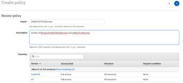

Then I followed Amazon FreeRTOS User Guide - Setting Up Your AWS Account and Permissions . By following this guide I’ve created a group and my first policy for this user.
 "Version": "2012-10-17",
 "Statement": [
 "Effect": "Allow",
 "Action": [
 "freertos:*",
 "iot:*"
 "Resource": "*"

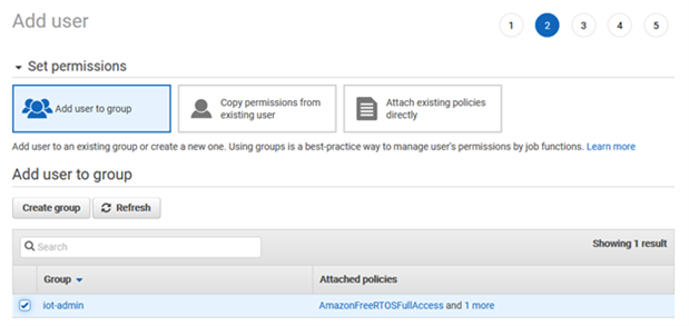

Than I’ve created a new user group to manage Amazon FreeRTOS  and IoT resources on AWS. And then created a new admin user in this group.

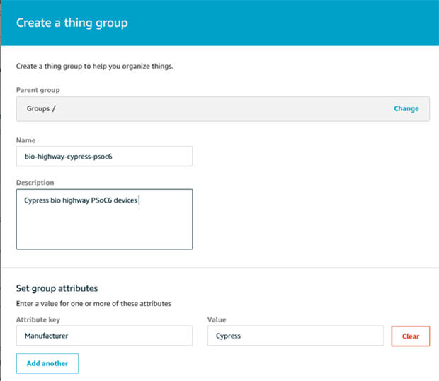

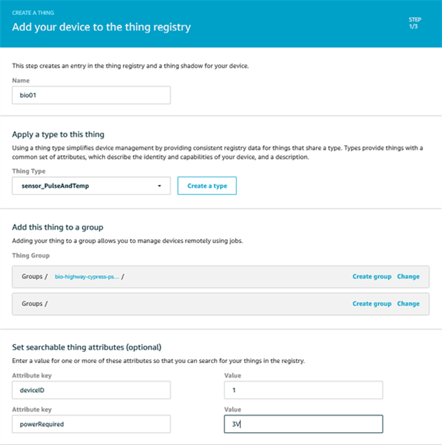

Than I’ve registered my Cypress MCU Board with AWS IoT following another Getting Started steps https://docs.aws.amazon.com/freertos/latest/userguide/get-started-freertos-thing.html. I’ve created a new thing group.
and created a new thing type with two attributes and added my MCU to it.
