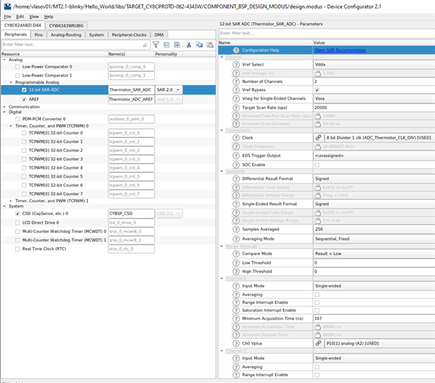

The last two weeks I've spent learning how to use MTB Device Configurator 2.1. In my previous post I've described my initial journey with MTB. I was able to fix Device Configurator 2.1 errors by enabling AREF and populating SAR ADC mandatory parameters. I've configured 12-bit SAR ADC  and AREF in Peripherals tab:

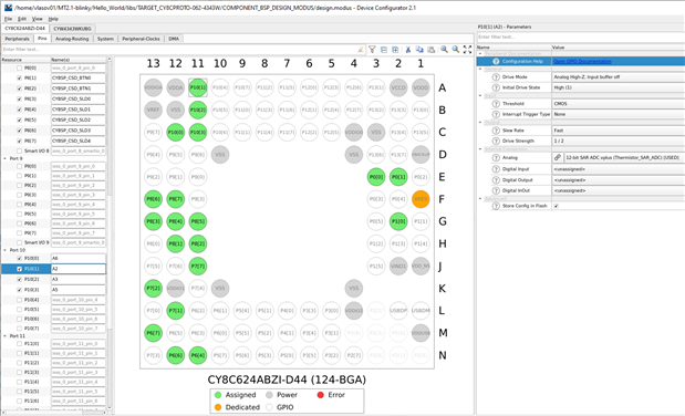

As well I connected Thermistor pins to SAR ADC in Pins tab:
And I was able to build the code and deploy it to my board without errors. But I was not able to find the way to initialize and use ADC components produced by the tool.

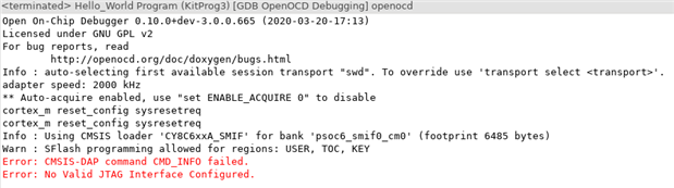

Than I've decided to verify with MTB Debugger if  SAR ADC has been initialized successfully.
While I was trying to do it I've got an error Open On-Chip Debugger:
I've reset the board and it started debug process without errors. So I was able to verify that there was no errors in cycfg_peripherals.c init_cycfg_peripherals().
