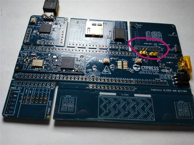

Adding headers
I decided that it is time to connect the sensor to CY8CPROTO-062-4343W board.
I've soldered headers to the board, so I can connect and disconnect my heart beat sensor easly.
I've used the same pins as where used by thermistor - P10_1, P10_2, P10_0 and P10_3. I was not able to identify other pins that allows connection of analog signal to ADC

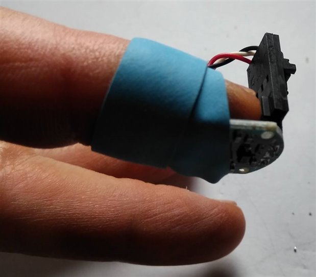

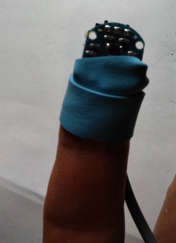

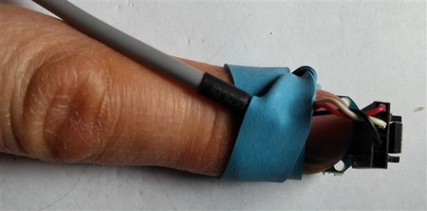

Wearable design
It will be much nicer to embed my heart beat sensor in a ring., but as I don't have 3D printer I've used other materials to attach it to my finger.
It was not too tight to allow free blood flow.. But it is tight enough to not loose it.image
