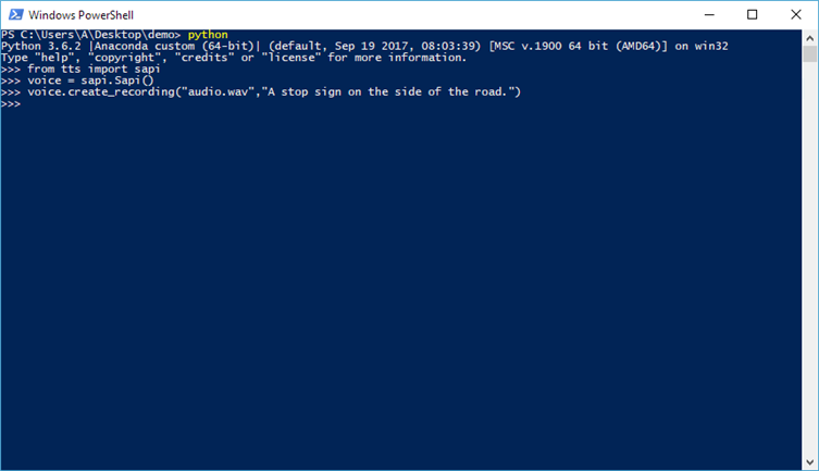

We use this library to implement TTS in our system. The idea is to send an image from the MKR to a server, have that server evaluate a caption for it, feed said caption to a TTS service, and send the resultant audio file back to the MKR.
We test out the library:

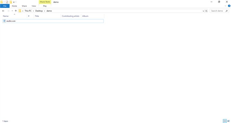

A file named audio.wav is created in the demo folder:
Here is the audio:

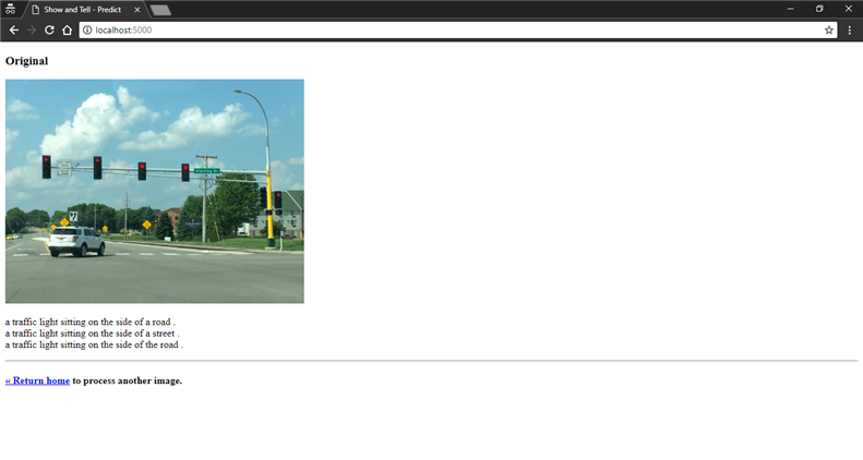

Now, let's test it on an actual image, using our Flask server:
The audio file generated for this image is:
