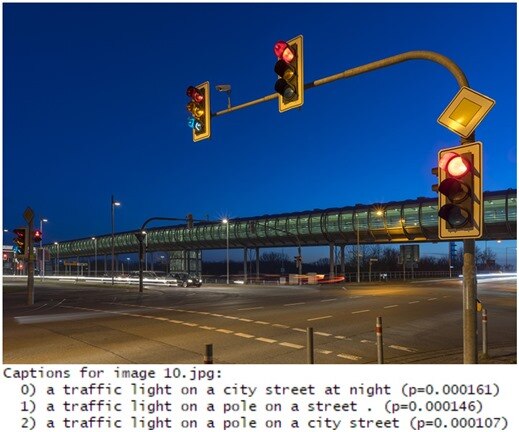

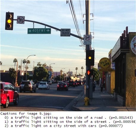

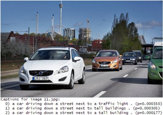

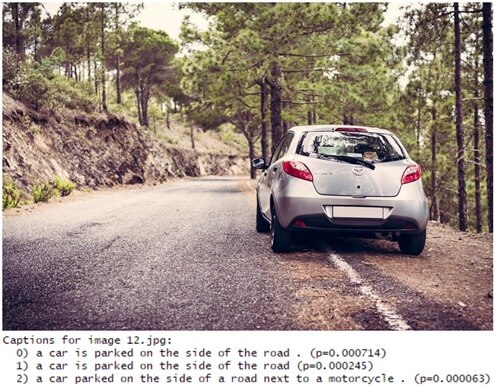

We trained the model over the COCO dataset for 1 million iterations before stopping. Here are the results on a few images:
Now, we are going to try some finetuning as well as increasing the number of iterations in the training sequence. We are positive that the captioning can only improve from here, and will keep you posted.
