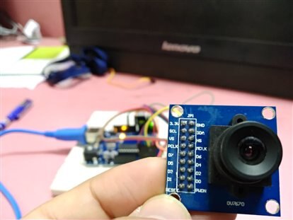

The OV7670 is a low voltage CMOS image sensor that provides the full functionality of a single chip VGA camera and image processor in a small footprint package. The OV7670 provides images in a variety of formats, controlled by the Serial Camera Control Bus (SCCB). More details about the sensor can be found on https://www.voti.nl/docs/OV7670.pdf
We have used the non FIFO camera here, so there is no buffer memory to store the pixel values taken in by the sensor. Therefore data is sent directly to storage bit by bit, so it takes longer to process an image than a camera with some memory would. The main reason to use this image sensor was that it costs just less than 5$ and can be used to quickly prototype the model on Arduino Uno to receive images on PC which is connected with the Uno. We do not intend to use this camera for the end product on the MKR, this was strictly for testing purposes to see how well our Deep Learning model does with images of low quality and black and white in color.

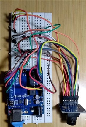

The pin diagram of the OV7670 connected with Arduino Uno is as follows -
Picture of Connecting the Pieces
After making the correct connections, we came up with a circuit like this -

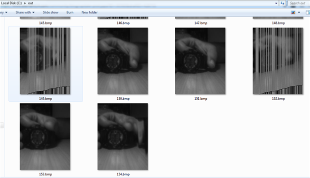

The procedure to get the images onto the PC's storage is a bit complicated but it has been described very well in the following instructable - https://www.instructables.com/id/OV7670-Without-FIFO-Very-Simple-Framecapture-With-/ . There is a java script which needs to be run in order to invoke the frame-grabber and it saves each frame in the folder C:/out -

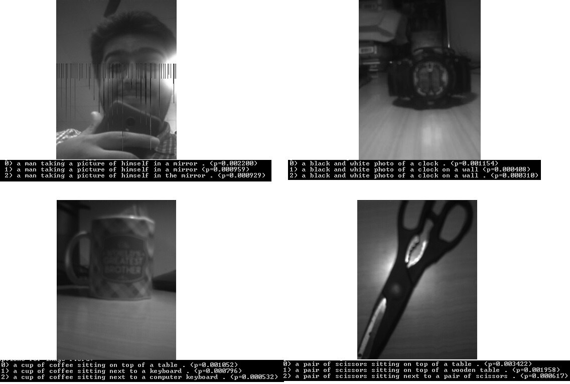

Since there is no FIFO memory with the image sensor, it takes about 6 seconds to grab every frame and save it to the above mentioned directory. The images are usually clear and undistorted but in case of movement of objects in the camera's perspective or the camera itself can cause some distortions in the images. Just to see how we our deep learning model does, we have taken a mix of images to infer the captions from them. The captured images along with their generated captions are displayed below -
The images despite being black and white and of size 240*320 pixels, are being captioned decently well by our DL model. Hence we are confident that with a better camera of 2 MP we will be able to generate captions for coloured images much more accurately. We have ordered the Arducam Mini 2 MP image sensor module, and it should be able to take pictures in plug and play for MKR1000. In the next blog we will be unboxing the OV2640 which is the Arducam mini 2MP, and a speaker for our text to audio output.
