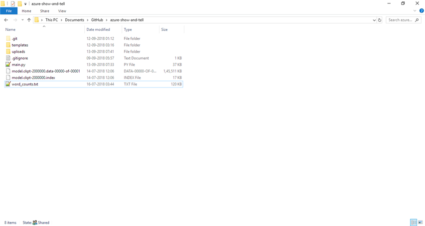

This is how the main folder looks:

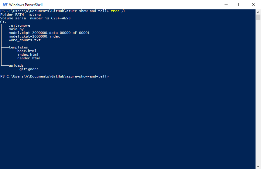

And here's how the file structure looks:

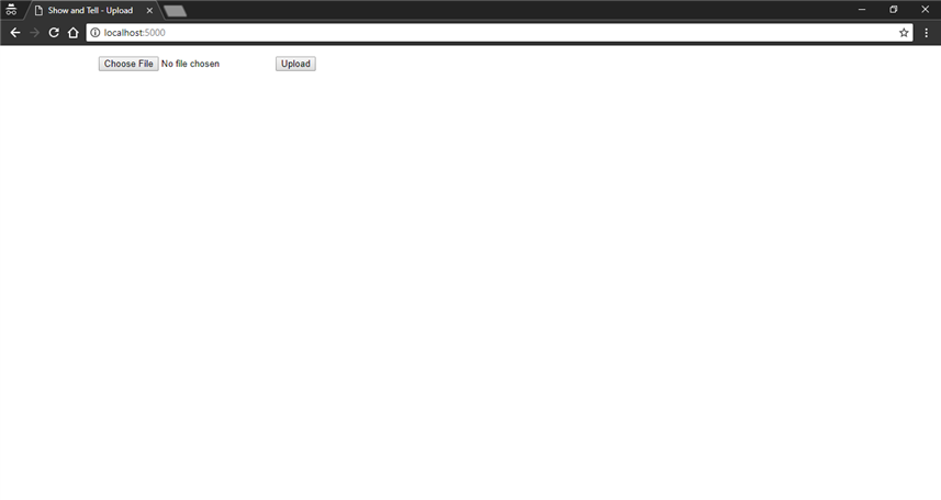

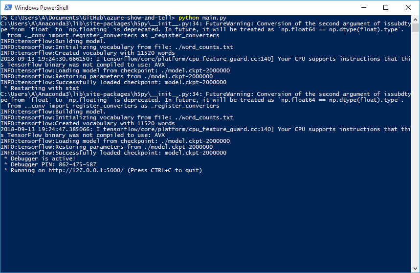

In order to start the server, we simply execute the main.py file.
We go to the site as shown in the image (http://127.0.0.1:5000/) (you can also use "localhost:5000" without the quotes).

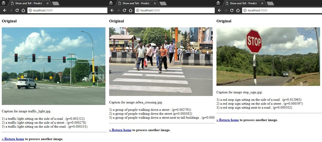

We upload the file of our choice and it displays the caption. We tried it on a couple of images:
When we press the "Upload" button on the homepage, the code sends a POST request along with an image to the flask server. The server then takes the image, puts it in storage, evaluates the model over said image, and displays the output prediction. The source html is programmatically written to display the image as well as the top 3 captions along with their predictions.
