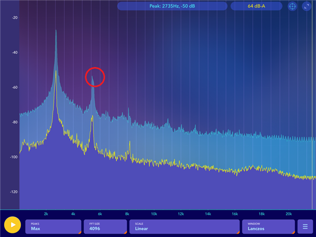

2. Analysis of the sound wave
Then, Record the sound and analysis the wave in frequency spectrum as follows,

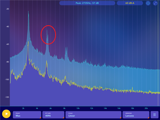

Repeat the sound wave catch.
It is easily to be found out that above two diagram is for same whistle in peak 2735Hz despite of different volume, -50dB via -57dB.
And the spectrum is similar. Be noted, it is not the same, since there is always difference in angle of blow, air pressure or temperature. It is obviously, the section marked in red circle is similar but not same. This give another feature in my design, there is no way Getting-Same-Blow even from same whistle. The meaning is Every recorded sound is fake.

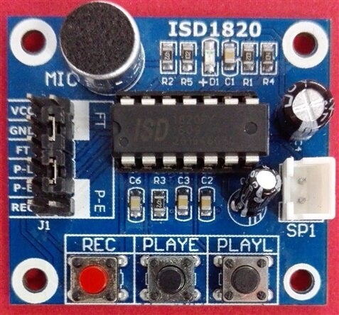

3. Introduction to ISD1820
As to the sound front end, ISD1820 module is used. It features analogue signal amplify, sound record and replay. The ISD1820 can drive speaker or earphone directly. Saving me from blowing each time when debugging.
