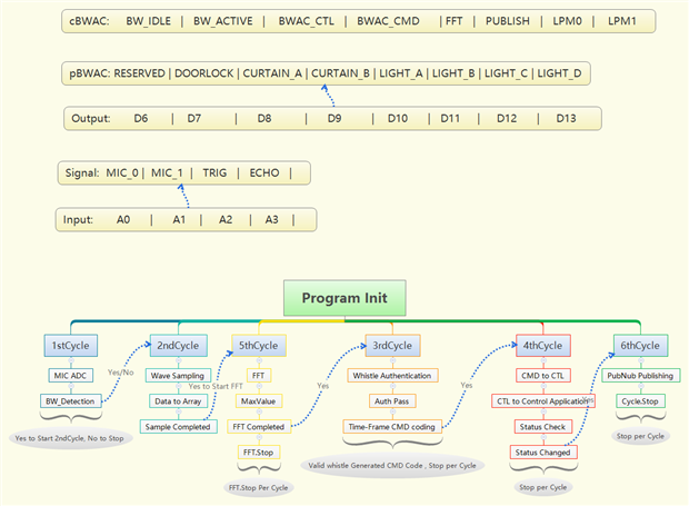

1. With thread-like control with Schedule Table, the control loop and Design is shown as follows,
The pBWAC and cPWAC are defined as byte, range 0x00H to 0xFFH.
In this diagram, cPWAC stands for cycles in bits,
                    and pPWAC  stands for control command to various home applicants like door-lock, lights. Corresponding to output pins,
                    with Input signals vsx assigned pins listed as well.
2. The program enter first Cycle for low frequency MIC ADC sampling, then triggers 2nd and 5rd cycles for whistle signals, then 3rd, 4th and 6th cycles for controlling.
The architecture of  schedule table can be migrated to other platform easily and make debug process faster.
3. The code Architecture shall be listed below. With Block Diagram above, it is easy to understand.

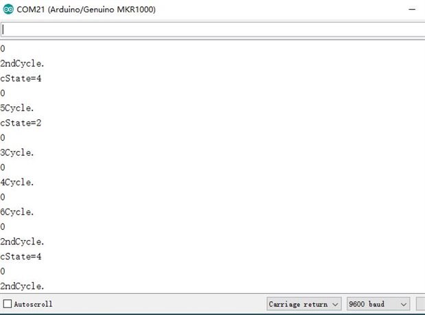

While the output of the running sequence shall be like this.
