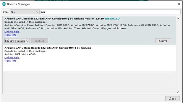

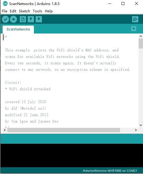

1. The core Hardware used in Blowing-Whistle as Controller(BWaC) is MKR1000 IoT bundle, which is supoorted by updated version Arduino 1.8.5,
but the board support for MKR1000 shall be download and installed first.

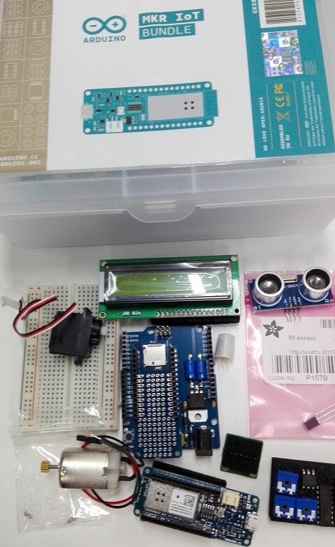

2. Arduino MKR1000 IoT Bundle
The Arduino MKR1000 IoT Bundle includes the MKR1000 board plus numerous electronic components, jumper wires, motors and a 400-point breadboard.
Arduino MKR1000  Dev Board (With Mounted Pin Headers)
Arduino MKR1000 is a powerful board for makers seeking to add Wi-Fi connectivity to their projects. It is based on the Atmel ATSAMW25 SoC (System on Chip) that is part of the SmartConnect family of Atmel Wireless devices

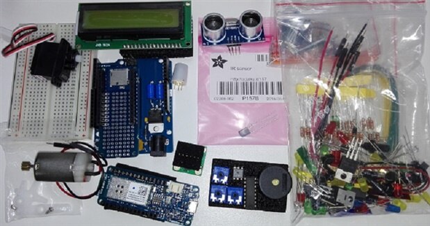

3. The Rest Hardware includes,
SD Card Shield for Arduino MKR, Daughter Board,
Arduino MKR1000 & UNO Shield Interface Adapter Board
LCD1602A panel,
9G servo, 5V motor with gear,
EKMC1601111PIR Sensor
ADXL335Z Evaluation Board
38KHz IR Sensor
HC-SR04 Ultrasonic Sensor for Arduino & Pi

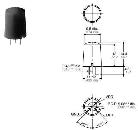

4.3 VZ series WL series Standard type, this could be used as presence detection for door-lock. Here is the
with wiring block diagram,

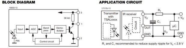

4.4 IR Receiver Modules for Remote Control Systems
These products are miniaturized IR receiver modules for infrared remote control systems. A PIN diode and a preamplifier are assembled on a leadframe, the epoxy package contains an IR filter. The demodulated output signal can be directly connected to a microprocessor for decoding.

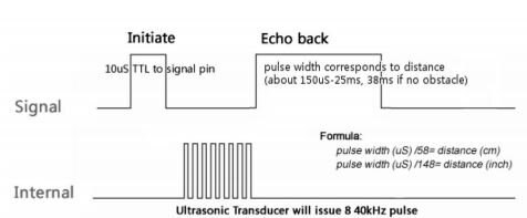

4.5 Ultrasonic ranging module : HC-SR04 with power supply of 5V DC,  quiescent current : <2mA ,effectual angle: <15°,  ranging distance : 2cm – 500 cm, resolution : 0.3 cm.
A short ultrasonic pulse is transmitted at the time 0, reflected by an object. The senor receives this signal and converts it to an electric signal. The next pulse can be transmitted when the echo is faded away. This time period is called cycle period. The recommend cycle period should be no less than 50ms. If a 10μs width trigger pulse is sent to the signal pin, the Ultrasonic module will output eight 40kHz ultrasonic signal and detect the echo back. The measured distance is proportional to the echo pulse width and can be calculated by the formula above. If no obstacle is detected, the output pin will give a 38ms high level signal.
