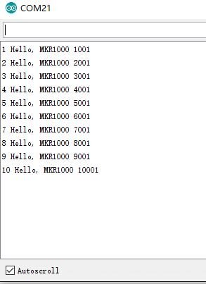

3. Here is the example of print hello 10 times,
#include <ScheduleTable.h>
SchedTable<1> helloCycle(1000);
void hello()
  static byte count = 0;
  Serial.print(++count);
  Serial.print(" Hello, MKR1000 ");
  Serial.println(millis());
void setup()
  Serial.begin(9600);
  helloCycle.at(1000,hello);
  helloCycle.start(10);
void loop()
{  ScheduleTable::update();}

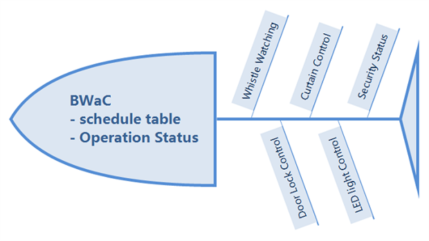

4. Here is my framework. The core process supervises the microphone module for control signal and screens for valid Whistle command. The  sensors and actuators polling the room status in schedule table even some are male-functional. Each command read the sensor or run the curator like servo or motor.
Any modification of the hardware would not interfere with other part of the codes.
Here is the diagram to be used in the program.
