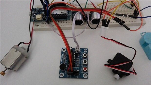

1. It really takes some time to complete the project, in prototype below.
Most of the efforts spend on Architecture of Design until I am notified the time is ticking.
Using Schedule Table and separated code blocks, I can put many ideas to be tested and improved continuously. This can only achieve merely basic functions. There are more works to do to make it useful platform for the proposed  BWaC protocol.

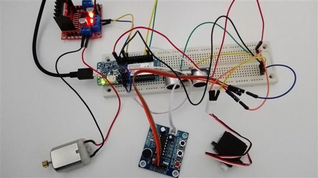

2. Here is the wiring before applying power on the USB port.
3. I would explain some main blocks and work to be done later.
