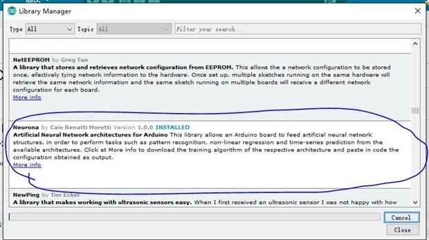

1. Although the prototype is built and there is not enough time digging the Neural Net in Arduino. It is still worth introducing Neurona library as powerful tools in voice reorganization in Edge Computing.
Import Neurona from library manager .
There is one example on color Senor.
#include <Neurona.h>
#include <LiquidCrystal.h>
MLP mlp(NET_INPUTS,NET_OUTPUTS,layerSizes,MLP::LOGISTIC,initW,true);

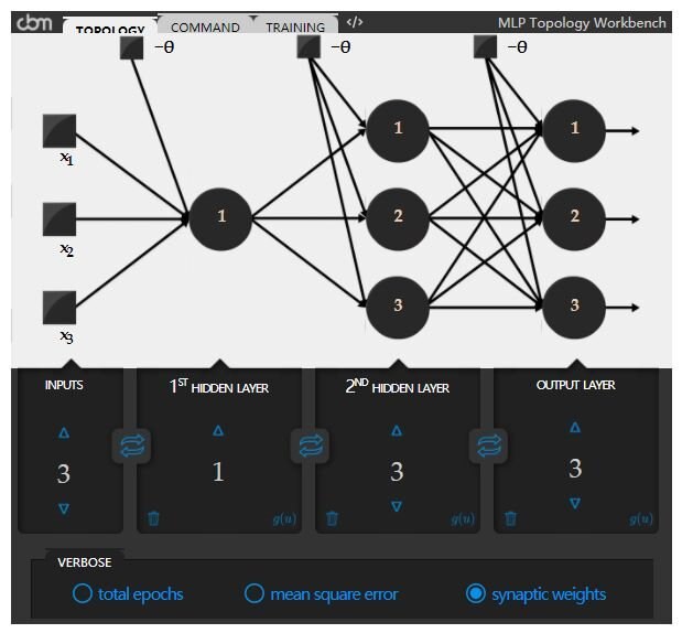

2. In Multi-Layer Perceptron - an implementation in C language, the neural network learning is introduced. Tool used for training is provided to.
3. How to use.
It can be used from above UI, and preset the layers. Or program in github can be downloaded and run locally. Simple as it is, the final goal is to train customized data array for Weight (W) .
In this example, the initial weight is given.
