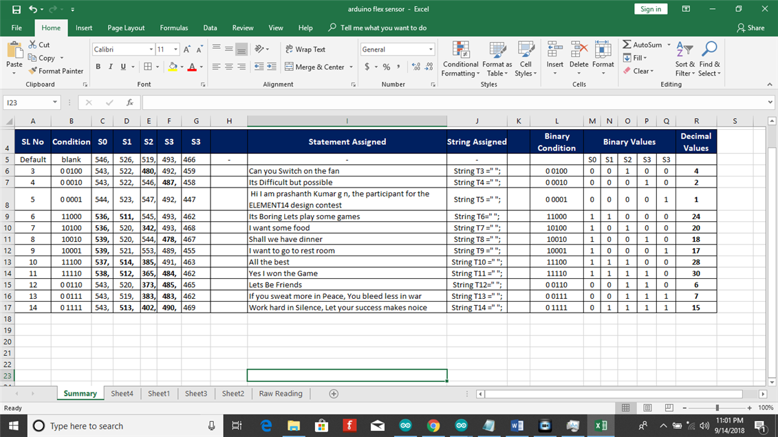

Here is my work on Sensor data collection and using those data for decoding the gestures
The bending of the finger is denoted as 1, not bending or rest condition is denoted as 0.
The analog data collected from each sensor is plotted as S0,s1..S4, and the corresponding statement for the gesture is assigned.
The analog values are made to digital using binary representation and also represented as a decimal value.
The Same Algorithm is used in the code.
