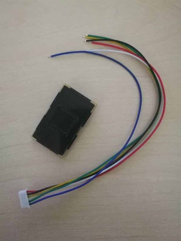

The fingerprint module I went with is from a company called GROW and the model R302. These modules are the easiest to find around, and they are relatively low cost, with my module coming in around 16 euros, and a couple of weeks waiting time for the shipment to arrive. One more great thing about the modules from the GROW company is that they have the full documentation online free for anyone to use. Here is a picture of what I received in the package.
{gallery} R302
Module: In the package I got the module itself as well as a cable for connecting to it.

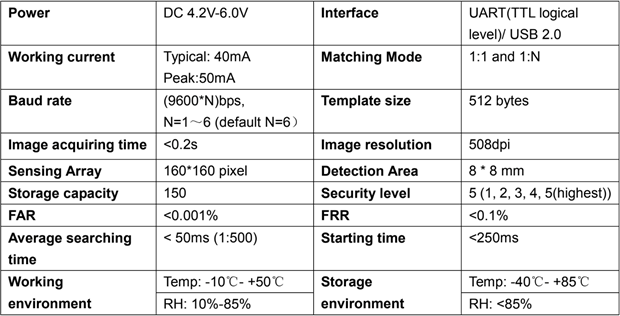

Table 1: General specification of the R302 module

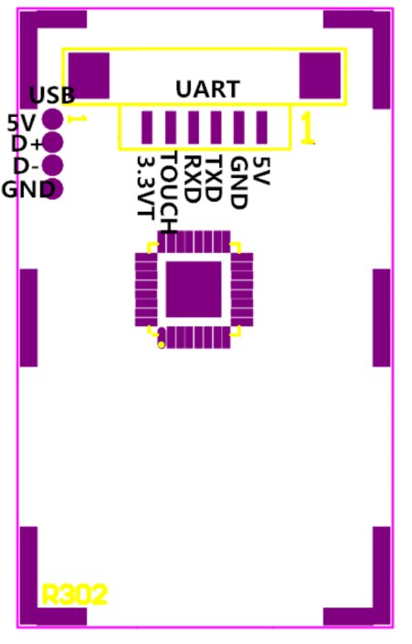

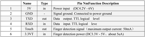

Pin layout: Pin layout of the module board, the UART part has a connector that goes with the included cable, while for the USB part we need to solder the wires to the PCB.
Table 2: Pins for UART
The cool thing about these modules is that they store all of the data on themselves, and they do all of the processing of the images, so they don't use up any of processing power of the Arduino or any other boards. There are 2 ways to connect the module to other devices, UART or USB. First off I wanted to connect it to my PC to see if the module is functioning as it should be. The first attempt was using the USB communication, which required soldering some wires to the PCB. When I would plug in the module into the PC, I could see it in the devices but had problems with getting it to work.(I would see it as a CD ROM, then it would transfer itself to USB devices and then would just say it has a problem, so I opted to go with the second method). After that failed I tried using UART. This of course required a converter to go in between.

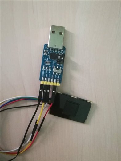

The connections between them are:
  1. 5V on the Module (red wire) --- 5V on the converter
  2. GND on the Module (black wire) --- GND on the converter
  3. TXD on the Module (yellow wire) --- RXD on the converter
  4. RXD on the Module (white wire) --- TXD on the converter
Next thing we need to is plug the converter into a USB port and try the module out. Of course for that we need to download a program. The one most commonly used with which I went with is the SFG Demo V2.0. It can be easily found online to download. After downloading the program all that's left is trying out to see if the module works! Here is a step by step guide on using the program with the module.

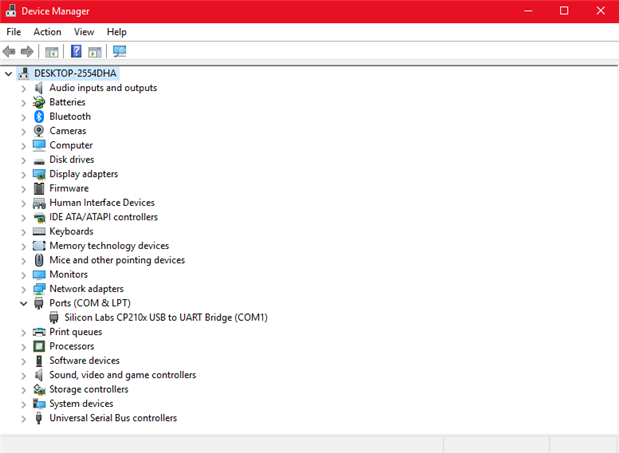

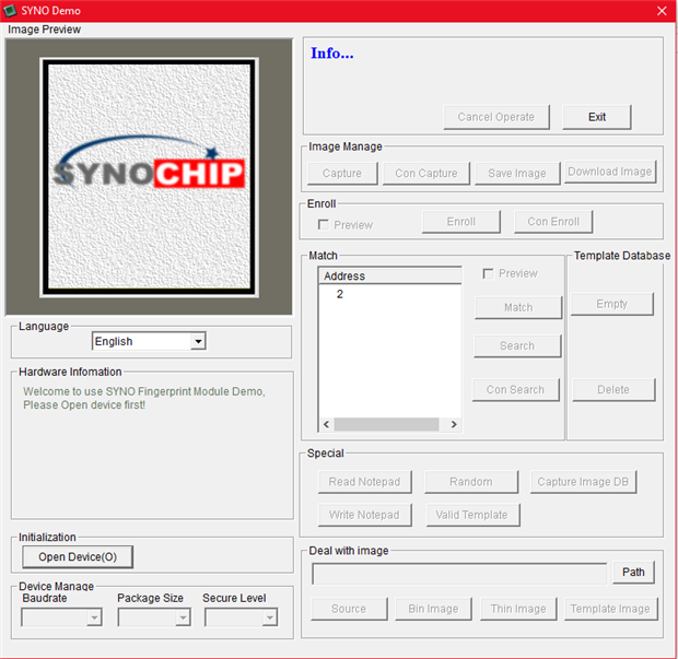

Device Manager: First off all we need to see to what port the module is connected which can be done going to the device manager, as we can see my module is connected to COM1.

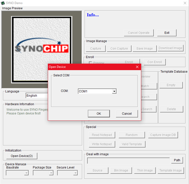

SYNO DEMO: This is the staring screen of the program, first we need to go and click Open Device.
Open Device: We will be greeted with a pop up screen asking us to select the port, for me that would be COM1.

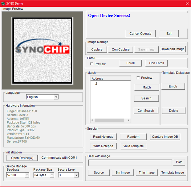

Module Info: If the module is not broken is connected correctly, we should see a screen like this. On the left we can see all of the hardware information, and we can also adjust the BAUDRATE, security level, and other things within the program. Now let's try enrolling a fingerprint.

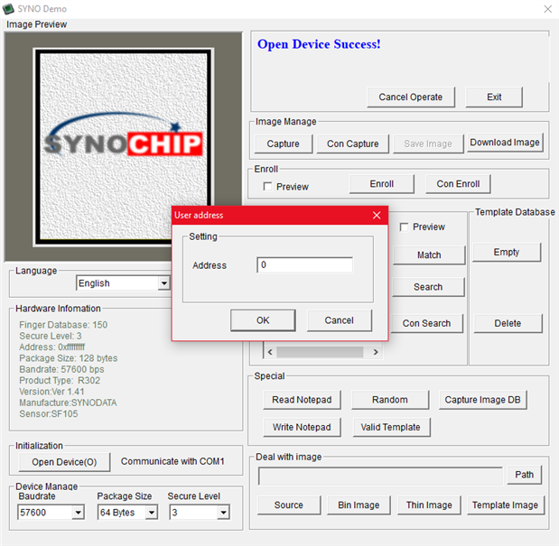

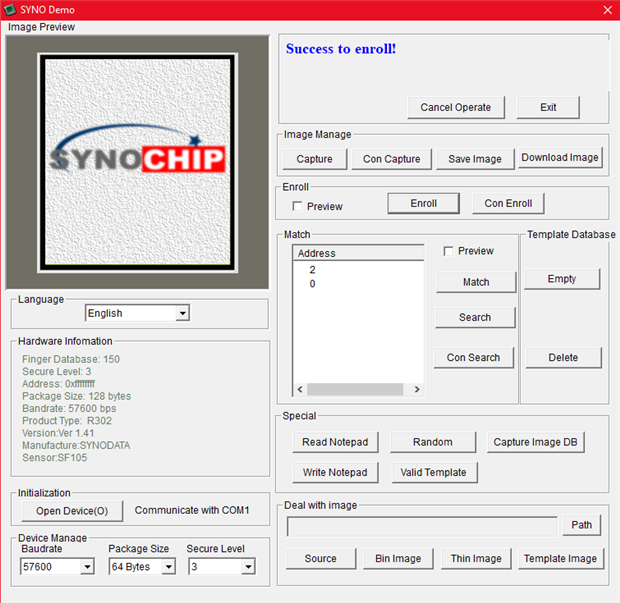

Enroll: We click the Enroll button and a pop up screen will come up asking us to which address on the module we want to save this fingerprint. Since this is the first time anyone has used this module, the memory is empty, so I just went with address zero. After clicking OK, the program will ask you to put your finger on the module and lift it off twice (a blue LED should be flashing when it is expecting a finger to be places).
Enroll success: If everything went smoothly we should get a message on the top saying success to enroll. And that would be how we add fingerprint to this module, now let's see how well the recognizing works. Also, if you want to see what kind of a picture the module creates of the fingerprint, you can click on the preview checkbox, but expect for the program to take a bit longer then.

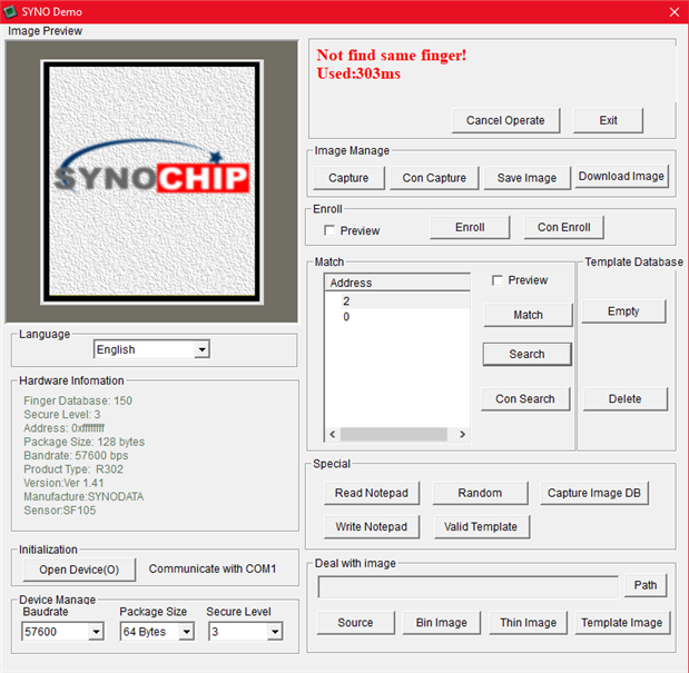

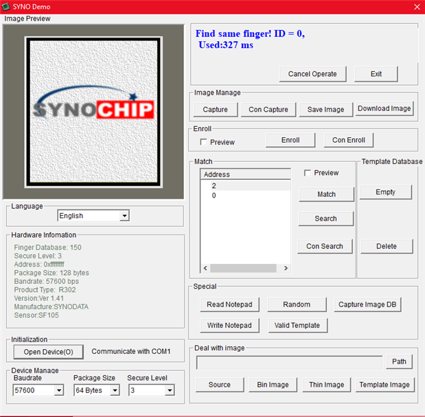

Search initiation: When we click the Search button it will ask us to place the finger on the module, and the blue LED will start flashing on it.
Search success: This is me placing the finger i enrolled on the module, and as we can see the device took only 327 ms to recognize the fingerprint. But now let's see what happens when we put a finger that's not enrolled there.
Search Fail: As we can see it can't find the finger within its database, and it again took only around 300 ms which is great!
I tried playing around with the sensor a bit, and while it works great, there are some things that should be addressed, but are not a total deal breaker. The pad on the module is decent sized, but not large enough for a whole fingerprint really, specially with 2 scans. Most phones now when you need to enroll a fingerprint require you to scan your finger tip from all angles, so the pad could more easily recognize your finger regardless of the finger position. Again, even like this, I am impressed with how smooth and fast it works, but will try fixing this issue by enrolling the same finger to a few different addresses from all sorts of angles. Now we have to connect this to the Arduino MKR1000.

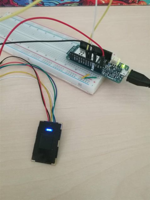

Connections are:
  1. Red wire on the module --- 5V on the Arduino
  2. Black wire on the module --- GND on the Arduino
  3. Yellow wire on the module --- RX Pin on the Arduino (13 on the MKR1000)
  4. Green wire on the module --- TX Pin on the Arduino (14 on the MKR1000)

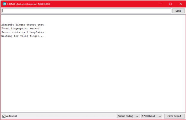

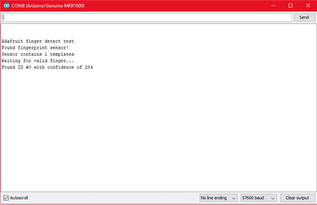

When we upload the program we have to open the serial monitor to get the whole thing going and we should be firstly greeted with this screen:
The one valid template is from when we enrolled the fingerprint using the PC, if there is time left I will be sure to incorporate enrolling fingerprints using Arduino as well!. After placing the correct finger on the sensor we should see a message like this:
We get the ID of the fingerprint, and as we can see it returned 0, just like we enrolled it in the first place, and besides that returns a number which represents how confident the module is. This is a great little feature which can be used to make the sensor a bit more secure by adding a threshold, but for now all we care about is if the finger is recognized or not. The library comes with a few more great examples, but I will be sticking to this one for now. Here is a video of switching between LED-s. One more LED we can see reacting is the module integrated LED, which usually flashes blue, but changes to red if it doesn't recognize the fingerprint.
