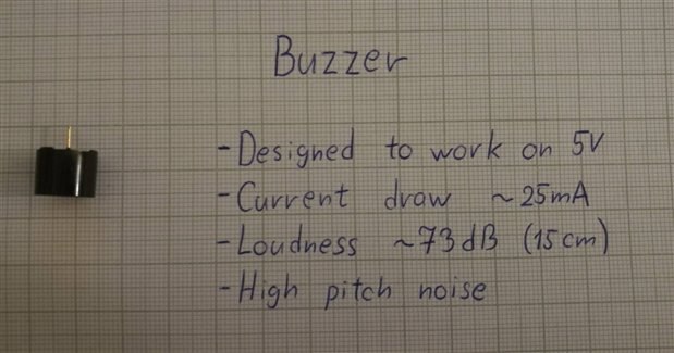

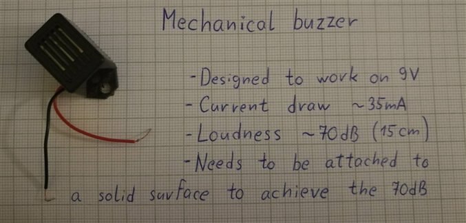

This is the second type of signals, here I have a choice between 2 different things, a standard buzzer and a mechanical buzzer. To see what is better I tested them to see how loud they are, their size and their current draw. So here is the comparison between them:
Doing these tests it made the choice easy, and it is the standard buzzer. It has a much higher pitch than the mechanical buzzer, draws less current, it's smaller and the mechanical buzzer has another big issue and that is to achieve the 70 dB it has to be firmly attached to a solid surface. One thing that did cross my mind, which I will try out, is using only the mechanical buzzer instead of a buzzer + vibration motor combo. Now we have to do something similar like with the LED-s. For "positive" actions (fingerprint recognized, key chosen,...) I will do short double beep, while for the most of the "negative" actions (fingerprint not recognized, tag not recognized, battery level low,...) a longer single beep. One more sensor I will be adding, as soon as it arrives, is a vibration sensor (for detecting falls), so in this case, the buzzer will go instantly and beep until the device is picked up. Another thing I would like to do is, like with the LED-s, do a certain number of beeps depending on the number of the tag, and of course when the mode for looking for the device is activated the buzzer will just go on and off.

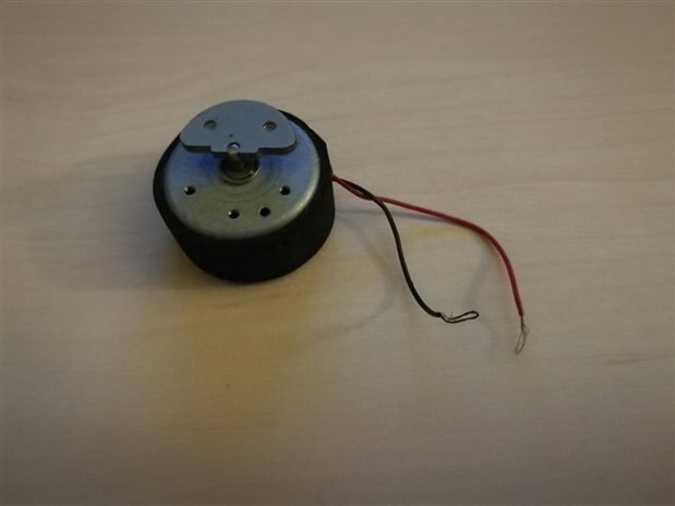

The general idea is using a vibration motor from a gamepad, they are designed for 5V anyway, but there are a few things about it. Draws a lot of current, and it's pretty powerful. I have few of them laying around, and this is the one that spins up the fastest of them all:
