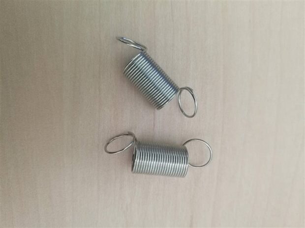

Springs: These are the springs I am using on this project. They are 8 mm in diameter and are long 12 mm. These are the smallest ones I have that have the strength that I want, most of the smaller ones I have are to stiff and would be hard to use. They are also the reason why the key trays have the long arm in the back, since we need the full key movement, but the spring can't go into the slots.

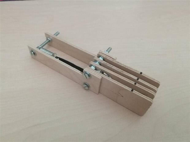

Assembly: The assembly without the keys and back screw
Assembly Front View: The assembly with the added back screw with a spring and a key attached to it
Assembly Back View: I won't cut down the screws down yet, since I plan on adding some electronics there, so I'll try using the screws as mounts or at least for mounting the outside shell on it.
Assembly Top View: In the top view we can see the problem with the front plates not being perfectly parallel one to another, which I will be solving with the key picking mechanism and with gluing a small plate underneath
