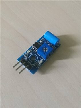

You might ask, why are a vibration sensor module? While it's not really necessary for this project, I thought it would be a good addition to the project. The way I plan on using the module is for fall detection. While this would require much more tinkering to work good, I thought it would be a good addition to the project. I will be using the SW-420 module. It comes with a potentiometer with which we can adjust how sensitive the module is. Let's connect it to a small test bench and try it out with an Arduino.

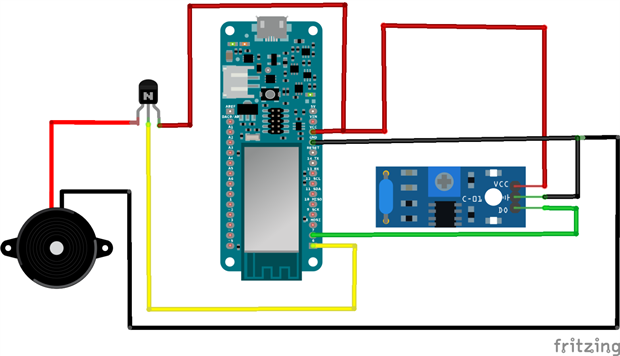

The connection to the Arduino is extremely simple, VCC --- 5V, GND --- GND, DO --- Pin 7. Besides the module I connected a buzzer to the circuit, because we will be activating the buzzer when the module is triggered. One more thing I connected in between is a small transistor since the pins on the Arduino aren't powerful enough for the buzzer. All that's left now is to code the Arduino.

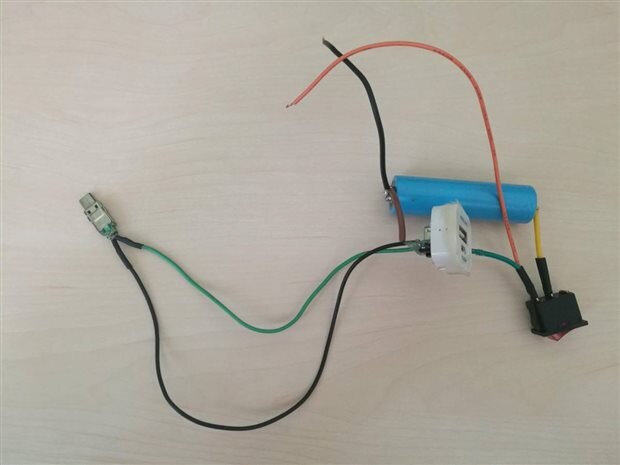

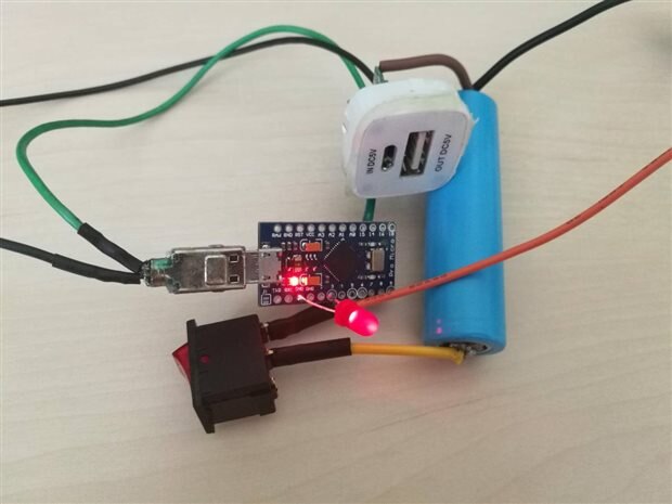

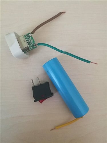

Since this is supposed to be a handheld device we need to have some sort of a battery on board. The Arduino MKR1000 has a connector for 3.7 V LiPo battery, but all of the one near me were pretty expensive, or had too long shipping time. So I decided with what I had, an old dismantled power bank. The great thing about this approach is that the power bank has an integrated voltage regulation circuit, as well as a charging circuit. This is all straight forward, to make it a bit more useful I added a switch and a small board for measuring voltage, which is essentially a voltage divider.
Build
{gallery} Battery
Parts: The parts I will be connecting together

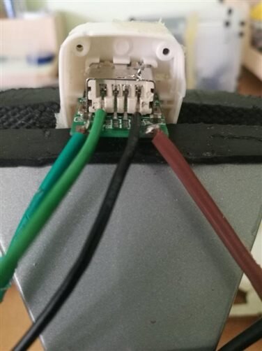

Output wires: I soldered the output wires of the voltage regulator on the back of the USB connector, the access is better there plus the whole device can be used as an ordinary power bank for charging other electronics.
Micro USB: For connecting to the Arduino I went with a micro USB. I was reading around and read that to power through the Vin pin I would need at least 6.2 V, so I just stuck with the micro USB port.
First test: To test out if everything worked correctly I connected it to a Pro Micro which also has the micro USB and everything worked great.
Test bench: And the last thing left to do is calibrate the voltage measuring circuit

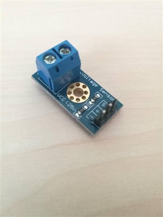

Measuring Voltage

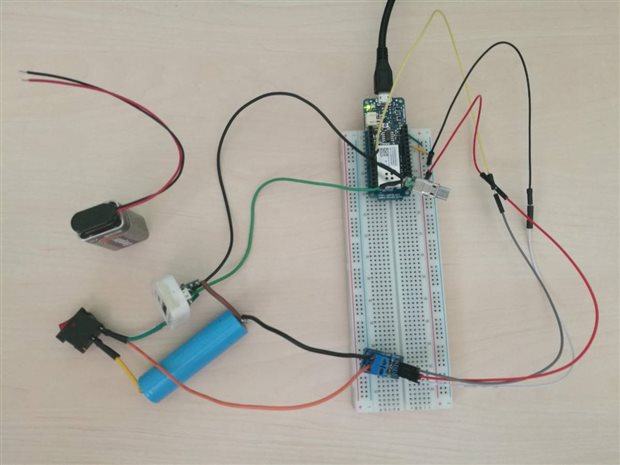

Now we come to the last step for this part, measuring voltage. For that, as I've said, I'm using a voltage divider.

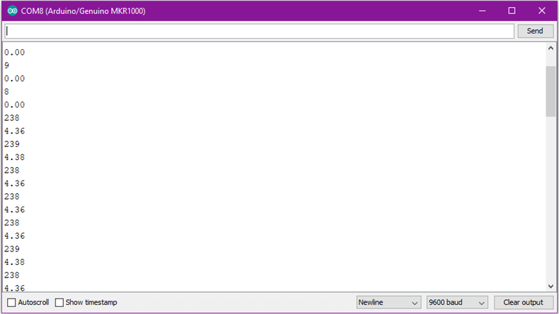

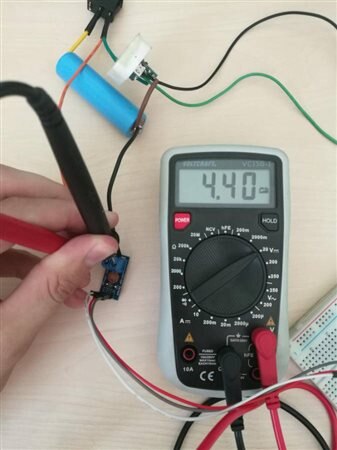

Connections to the Arduino are really simple, we connect the battery to the screw terminal, + and - to 5V and GND, and the S+ Pin to A6 or any other analog pin on the Arduino. The voltage from the voltage regulator was really stable, while the battery voltage had variations in the neighborhood of around +/- 0.04 V. So to calibrate the system as best as I can I used a standard 9 V battery (which had a voltage of 11 V) to calibrate everything. In the end here is the code and comparison between Arduino measuring and a voltmeter.

Comparison with a voltmeter
On the serial monitor the moment where I turned on the switch can be seen with the voltage jump. On the voltmeter I was getting voltages from 4.38-4.40 while the Arduino was showing 4.36-4.38, which is accurate enough for my needs with this project.
