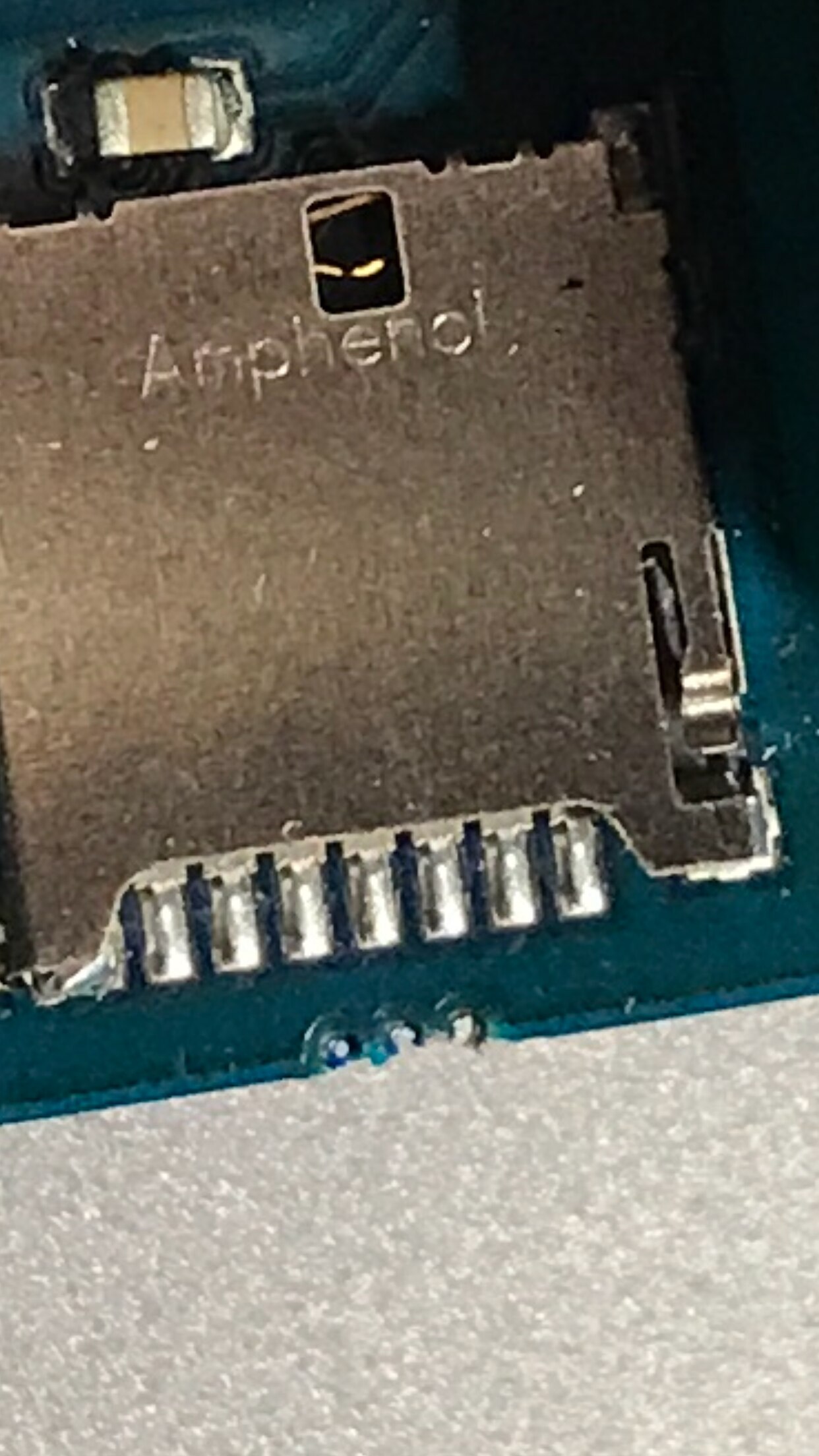

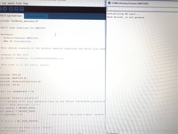

Well, I have been running some code to test reading from the SD card on the Proto Shield and it has not been working.
I tested two different codes to read the card reader and it isn't working.
I formatted the SD card with the downloaded program SD Card Formatter to the correct specs and still code doesn't recognize the card reader no matter what I try.
This is what I get as an error when I run the code:
There are some sites that indicate that there is a known issue with the card reader on these proto boards. Anyone else have this kind of issue or see it themselves?
I did find an article on the Arduino website that says that pin 3 of the SD card reader is not connected to ground and once he soldered a wire from pin 3 to the SD card reader case, it worked.
I will try that later on. Right now I have wasted most of today trying to get this card reader to work with no joy so far!

    I had trouble at first with an existing 64gig disk. So, I found an old 8gig and formatted to FAT. It worked. Twice it did it again, but pulling the card out and reinserting fixed that - or maybe just trying…
  • Sean_Miller
    Sean_Miller over 8 years ago
    I had trouble at first with an existing 64gig disk.  So, I found an old 8gig and formatted to FAT.  It worked.  Twice it did it again, but pulling the card out and reinserting fixed that - or maybe just trying again would have been successful instead.
    Be sure you don't have anything tied to these pins or have your code address them:
    D4,D8, D9, and D10
    Good luck with it.
