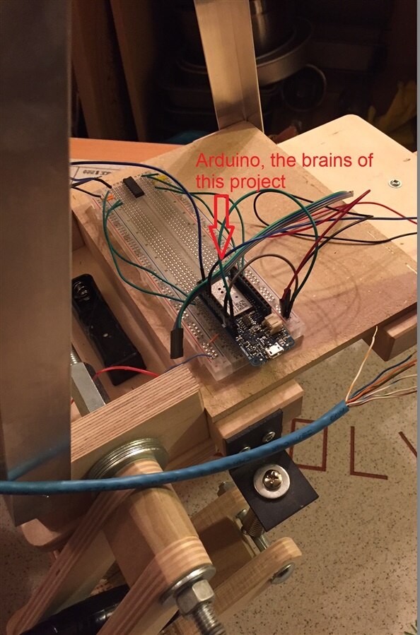

This blog is to do with assembling the SeeingEyeduino. In the past week I have made up most of the remaining parts for my project. The Braille finger pad was the most important part of this project. Below are pictures of where I am at, I will explain each photo and give details. If there is anything you have questions, comments or ideas on, please leave a reply. Every little bit helps!!

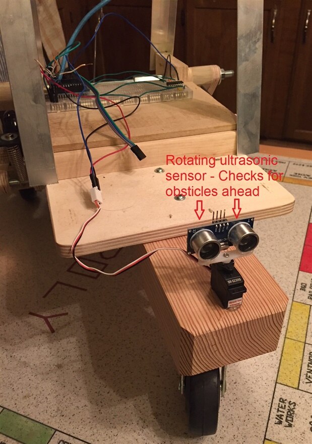

Below is the ultrasonic sensor attached to the servo to check for obstacles ahead.
I attached the Arduino to a breadboard  to make it easier for attaching the wiring. On the other end of the breadboard is the L298 IC motor controller (This may or may not be used at this time as I will probably not be using the drive motors)

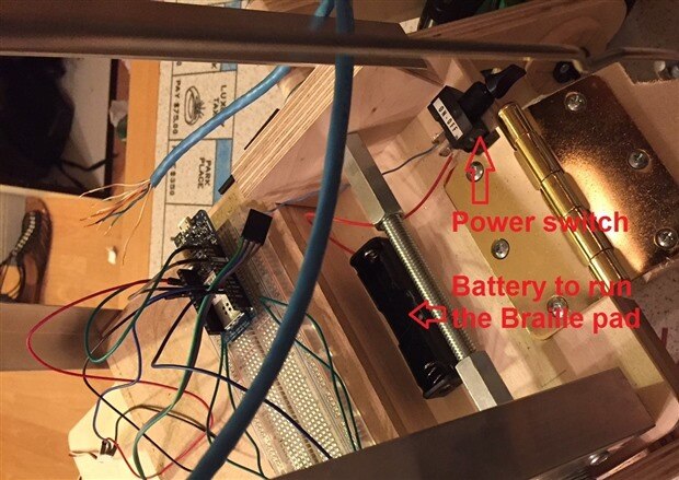

Here I have the battery slot to run the Braille pad. It take a 18650 3.7v battery. I also added in a power switch, this will be moved to where you hold onto the SeeingEyeduino for easy access.

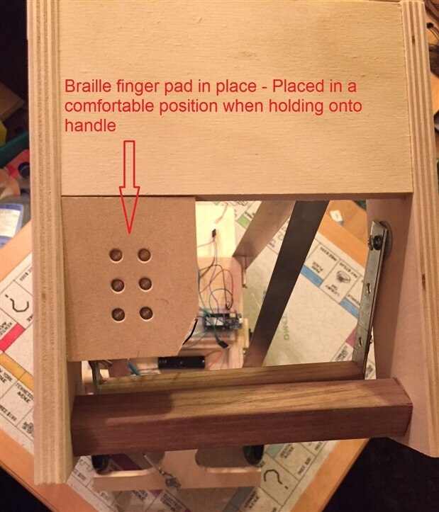

As you can see in the next picture I have the handle and Braille pad. Since I don't have a 3d printer I made it out of wood. The actuators go 1/2 mm above the face of the pad. This makes it a comfortable height.

    Nice progress dwinhold and it is always happy to see things coming the way we expected. Good luck for the remaining part. Just out of curiosity, will the braille system be felt by people's hand? Like if…
  • dwinhold
    dwinhold over 8 years ago in reply to dixonselvan +2
    Hi Dixon, The Braille pad is small, the top third of your index finger size. The actuators are very small and have just enough power to extend all the way. With little force you can push them down, I had…

    Hi Dixon,
    The Braille pad is small, the top third of your index finger size. The actuators are very small and have just enough power to extend all the way. With little force you can push them down, I had it spelling Braille on my finger for around 5 minutes and there was no pain or discomfort at all. This was a concern of mine as well so I tested this out a lot.
    Thank you for the comment and question
    Dale W
  • dixonselvan
    dixonselvan over 8 years ago
    Just out of curiosity, will the braille system be felt by people's hand? Like if they need to keep their hand to understand the full message, will it not be hurting a bit because of the solenoids? Can an arrangement like rubber be placed to reduce the impact?
