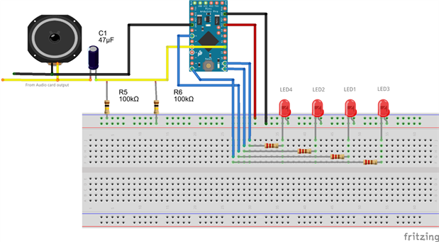

I completed the mouth and the MagicHat now can speak.
I had to make some changes to the circuit for reading audio output. The new version includes two resistors and a capacitor to shift up voltage level by 2.5V

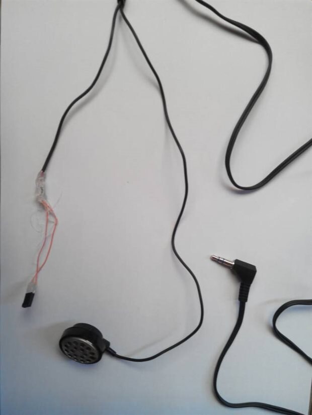

Using an headphone, I cut off one of the speakers and added a connector to be connected to the Arduino board

    I like it, nice idea using the headphone as a mini-speaker.
