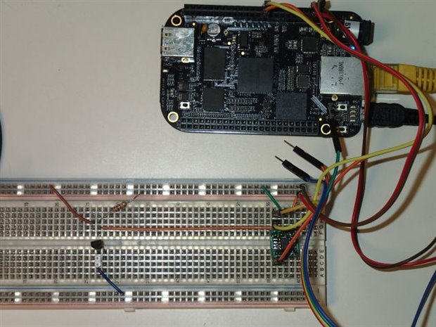

To eliminate as many unknowns from the equation I decided to test using my BeagleBone Black which I am more used to than the SAMA5D4.
On the BBB the P9-19 and 20 are the I2C-1 which I am going to use. The DS2482-100's SDA and SCL are 3.3 V capable so they can be connected directly. The Linux configuration does not have to be changed since the I2C-1 is enabled by default. Connect the DS24B33 EEPROM and I am done! Right? First test it with i2cdetect:

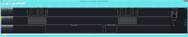

Fortunately I've bought a simple USB 8-channel logic analyzer a while ago. Never used it seriously, though. Looks like is time again to learn something new. I have taped the SDA and SDL pins to see if the DS2482 works correctly. I already could verify that it is listening on address 0x18.

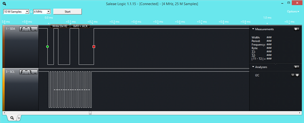

The first action on the bus is not a surprise - we see a write to address 0x18 (the address of the bus master) and then the byte 0xF0 which is the command "Device Reset". Good.

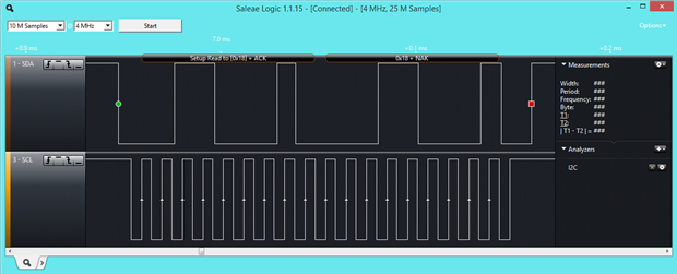

I had not expected to see the read from address 0x18, but reading the data sheet I found the recommendation to read the status register to verify if the reset was performed. After reset the read pointer points to the status register, therefore a simple read will result in the value of the status register. Here it is 0x18 or in binary 0b00011000. The status register bits are DIR-TSB-SBR-RST-LL-SD-PPD-1WB where:
Bit NameDescripiton
DIRBranch Direction Taken
TSBTriplet Second Bit
SBRSingle Bit Result
RSTDevice Reset: Reset has been performed.
LLLogic Level: Reads the logic state of the 1-Wire bus without initialising a communication. Updated on every read
SDShort Detected: Updated on every 1-Wire command.
PPDPresence Pulse Detect: Set when a presence detect pulse is seen by the bus master. Updated on every reset.
1WB1-Wire Busy: reports if the bus is currently in use.
The three most significant bits are for data transfer on the 1-wire bus, the others are real status bits. In this case the RST and LL are set which means the reset was performed and the 1-Wire bus is in "high" state.

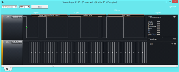

Then the next command is written to the I2C bus: 0xE1 (Set Read Pointer) 0xF0 (Status Register). So the next command has to be a read. It resulted in 0x18, the same as above.

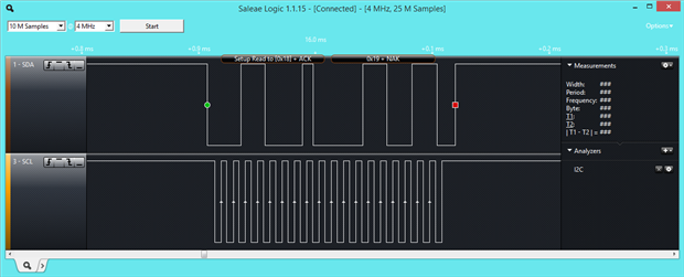

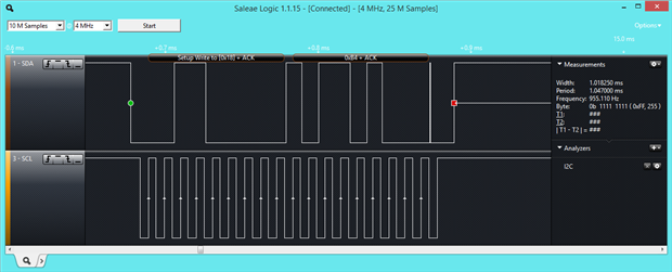

This time 0xB4 is written to the DS2482. This is the command for 1-Wire reset.
The status register is read again, but this time the result is 0x19 so the least significant bit has changed to "high" which means the 1-Wire bus is busy. The host has to wait until the command has finished. The next read returned 0x18, again. The reset was completed but no presence pulse detected. That's why I could not access any 1-Wire devices. But why? I checked the whole circuit and found two really stupid mistakes: on the 1 wire eeprom (DS24B33) the ground pin was connected to the 3V3 pin and the pull-up resistor's bands had the colours red-red-brown which is 220 Ω. The data sheet says Rpullup should be between 0.3 and 2.2 kΩ. I looked for a red-red-red labelled resistor and installed it instead. This time I got this result:
Finally there is the Presence Detect Pulse!  The rest of the communication read the 1-Wire ID form the DS24B33. Now the key identification works.
