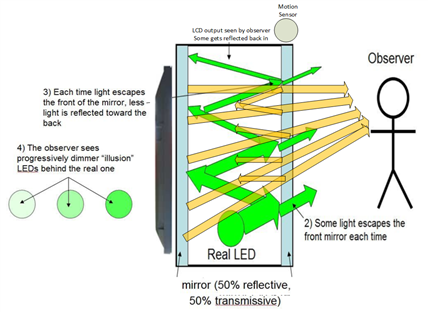

So my proposal for an enchanted objects is a Mirror, but just not an ordinary one...
The intention is to produce a marriage of an Infinity Mirror, a 23" ish LCD panel and a series of sensors and internet connected IOT feeds both providing and using the cloud to provide local weather on the mirror as well as possibly reminders, a video feed of people coming to the front door so you can see before you open it and of course the LEDs of the infinity mirror can adjust colours based on the weather, orange for warm, blue for cold, red for blistering hot, and other effects for Rain etc. Time permitting I will also be adding to the scope of the Mirror by having it interact with other household objects, but ill keep that a surprise
It will be having sensors inside the house and outside in order to detect the required events and if I am able to figure out a few things, perhaps facial recognition or voice so that you can ask questions of a few topics
Now this initial post is regarding a proof of concept to see if the approach im using will work for the infinity mirror before I commit the LCD and other much more expensive items to the tools
The Mirror film I have is from Home Depot here in Canada
http://www.homedepot.ca/product/mirrored-privacy-window-film-3-feet-x-15-feet/919621
and is intended for use with Glass, not Plexy or Acrylic so I need to now if it will work. Also an infinity mirror normally has a full back mirror and a two way front mirror, I need to use two 2 way mirrors as the LCD will be behind the mirror and need to shine through when displays are needed
Here is how an Infinity Mirror is supposed to work, the observer looking toward the darker side will see a reflection of themselves and the emitted LED light, in this case there will also be the light from the LCD panel
Mine will be 50% on the back too as I need to have an LCD screen behind it
I have produced this intro video that also demonstrates a proof of concept for the infinity mirror

    Hi Peter,
    Cool concept, we have the 2way Plexiglas at work, left over from a project. If interested I could send you some for testing out. I really like your idea.
    Dale

    That would be wonderful if possible
    What would you want for it, and how big are the sheets, i would need to check out shipping costs (Alberta to Ontario) ?
    The sheets using the film, work well enough but are not as good as I hoped
    Thanks
    Peter

    Hi Peter,
    The plexi wouldn't cost you anything, I would see how much for sending, how big of pieces would you require? I will get pictures and a video uploaded for you tomorrow so you can see exactly what it is that I have.
    Dale

    Hi Peter,
    Sorry for the delay, attached are pictures of what I have. The size of the pieces are 4' X 4' and 2' X 4', I could cut to any size you would like. If you are interested and have use for your project I can find out how much to send it to you.
    It's hard getting pictures that give the full effect.
    Dale

    That stuff look awesome, and its mirror will be much better than film based as it will have been put on with spray or something
    I am looking for my target monitor then I will know the size I will need, though being a 24" screen + the borders for the infinity mirror one dimention will still be in excess of 3 feet but I will confirm the other this weekend
    as the pieces are 4' that would leave pretty useless leftovers for you so it will be interesting to know how much to send the 4' pieces
