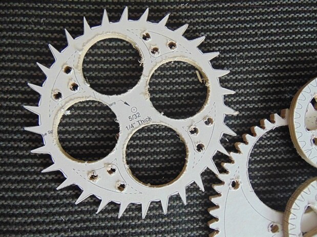

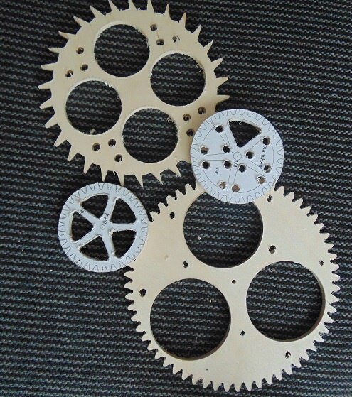

Clock building:
This is a slower then hught process, a lot of scroll sawing in making gears. I keep getting tempted with the CNC machine, but this I want to do by hand. Chrystal has been helping cutting out the gears as she has learned patience (from me of coarse). Below are pictures of the gears:

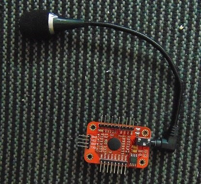

Next we have finaly received our voice recognition module. Attached are pictures and some sample programming:

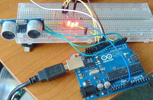

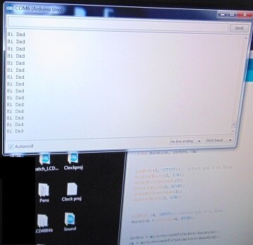

We also added in a famly member recognition program. Here we are using an ultrasonic sensor which wil be integrated into the clock to sense te height of whoever is in front of the clock. The clock will communicate personally with the family member by name. At thi time I have it to light up LED's as the rcognition, my wife is set for 3 lighs, at the tme of the screen shot it was recognising myself. Below are pictures and programming:

  • Workshopshed
    Impressive escapement wheel, what kind of escapement mechanism does the clock use?
  • Workshopshed
