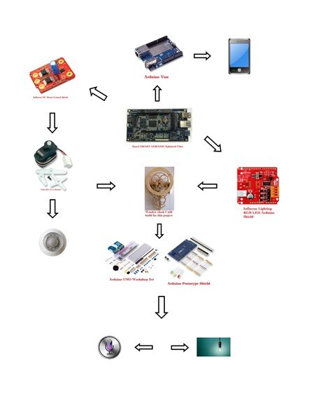

Chrystal and I would like to thank all the sponsors, Element14 and everyone involved for choosing us to compete in this challenge.
Our enchanted clock is going to be very special. The clock is going to be hand made by Chrystal and myself, all made from wood (recycled wood). All the working parts are going to be made from wood as well (Gears, hands, weights etc.) I am a cabinetmaker by trade and need a new challenge so building a wooden clock fit right into this challenge perfectly.
The clock will be enchanted beyond imagination, this will include:
  • A humidity regulator for the clock - Wood clocks only work for around 9 months a year due to the seasons cause the wood to move. Since the gears are hand fitted and made of wood, when the wood expands and contracts with humidity it causes the clock to stop. With a humidity regulator it will keep this from happening.
  • Wood clocks usually lose or gain time due to imperfections -This will be corrected twice a day automatically
  • You can't have an enchanted clock without voice control - To dark to see the time? Just ask -  A little cold in the room? Ask the clock to turn up the temperature - Need lights on? Just ask... oops, dad's sleeping, the clock will only turn the lights on dim as not to wake him.
  • The clock will know if no one is in the room and turn the lights off to save energy.
  • Forgot to wind the weights? Don't worry it will be done for you.
  • Need to check on the house while away? Check your phone and ask the clock for information (Encrypted of coarse)
Below is a flow chart of the way this will work:

    Robert Peter Oakes over 11 years ago in reply to dwinhold
    I just followed the links for the servo and it is most definitely a PWM one so your good using the UNO or SAM board directly tot he PWM  (NO Infineon Motor controller needed)

    dwinhold over 11 years ago in reply to Robert Peter Oakes
    Hmmm, there is definitely going to be a change. I didn't even notice this, I will be running the servo from the Arduino instead. Thank you for pointing this out, makes planning easier when errors are caught early.
    Dale and anyone else thinking the same
    Just a word of caution
    The Servo looks to be a PWM servo as found in remote controlled models, it can not be driven by the Infineon Motor control board as you depict in your diagram, but you can in fact drive it directly from the Arduino or SAMA5D4 board
    if you look at the picture of it, there are 3 wires, two for the power and one for the PWM (White one)
    There is nothing to stop you getting a different motor though and adding it to the collection
    Nice project idea btw
