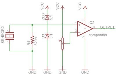

In the morning Hans had a couple of thoughts, the first was he wanted to upgrade his security and the other was that it might be quite good for the system to check the weather automatically in response to people knocking on the door.
Hans realised that there was a buzzer in the Arduino kit and looked into taking that apart to use as a sensor. It did not want to open up easily so he invested in some new sensors, some simple piezo transducers.
A bit of googling found a suitable circuit for conditioning the sensor signal. The piezo transducer is effectively a voltage source, when the crystal deforms a small voltage is produced. If we put that into a comparator then we can create a strong 0v - 5v swing to indicate the knock. This should be sufficient to wake the Arduino from sleep. A large resistor allows that voltage to discharge and zener diodes stop the inputs being overloaded.
From Thoughts on interfacing piezo vibration sensor - Do It Easy With ScienceProg
Looking in the spares cupboard there were a bunch of 741 opamps that could be used for the comparator but checking the spec he realised that they were not designed to work from a 5v supply, and there were also comments that the output swing was less than the rails so some LM393 comparators were also ordered.

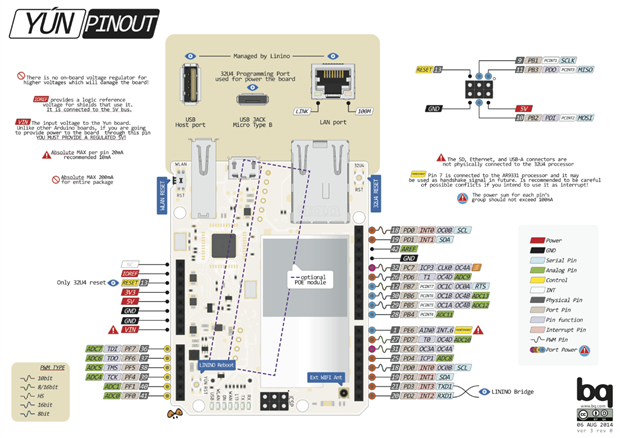

Whilst he was waiting for those he did some tests with the interrupts. Reading the Arduino site he learn that only certain pins could be configured as an external interrupt. Looking at the pin out diagram, all of there are taken by the bridge to the Linino module or the I2C bus.
from http://www.pighixxx.com/test/pinoutspg/boards/
Hans saw a cryptic comment in the Arduino documentation that some of the Atmel chips supported change interrupts on many more pins. But there was no specific reference to the Yún or the ATMega32u4 and no details on how to how to attach the interrupt handler code to the pin. Luckily Matt Walkers article on Pin Change Interupts explained how it all worked and a bit of further digging found Mike Schwager's library that wraps up all the AVR specific commands in a friendly way.
