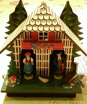

Putting on the roof
One of the big physical jobs left for Matilda and Hans was putting the roof back on. They realised that they could not do the job by themselves so they wandered down the Adam and Eve Inn to look for volunteers. It turned out that everyone wanted to help so the barkeeper closed the pub and he and the snake came along too.
The helpers were of various use, the Dwarves spent most of the time arguing and Farmer Hogg kept saying things like "I'd not have started from here". However the barkeeper and snake were very useful. Whenever the barkeeper wanted the snake to do something he'd command "Python Start" and whenever a job was done he'd say "Python Stop". The roof was quickly done and Hans and Matilda posed for a photo.
They thanked everyone who in turn decided to go back to the inn to celebrate. Hans and Matilda had plenty to do so celebrating would have to wait.
