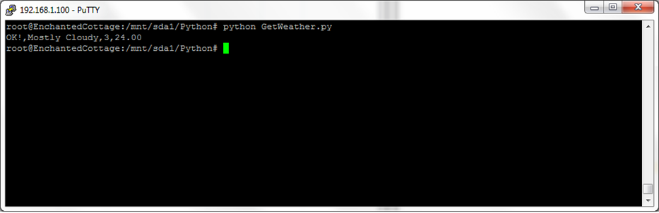

As mentioned in a previous installment Hans was having some trouble installing the secure version of the requests module for python, it didn't matter what he tried there always seemed to be something that needed a different version of a tool installing or a script that did not want to run correctly. So Hans took some steps back and wrote the code to get the weather instead.
Thinking about the reason for using requests in the first place it was to make the code simpler, however the function to call the API was small and self contained so Hans realised he could swap that out with pycurl instead. So he installed the relevant packages.
opkg update
opkg install python-openssl
opkg install python-curl
And updated the Python script to use pycurl, he coded it so that either version could be used by swapping out call_api. For the pycurl commands to work an old version of the call was needed, c.setopt(c.WRITEFUNCTION, r.write) rather than c.setopt(c.WRITEDATA, r).

The first run reported an error with not being able to verify the certificate so he re-installed the certificates using a slightly modified script that downloaded the certificates from OpenWRT, as the Yun pakcage repository does not seem to have these.

Running it a second time produced a result. Hans had never been so happy to know that it was Mostly Cloudy in Chicago, IL.
